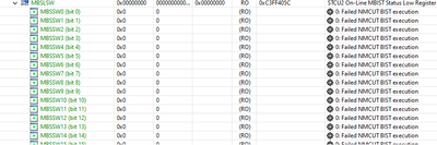

I have been running the online bist that i took from the application note AN5288, but when i debug the code it seems that it is stuck in if statement ( if (STCU2->LBESW == 0)), below the status of the register and the code that i have been running:

    /* ASSUMPTION sysclk: PLL SET TO 50 MHz when this function is called */
SIU->SYSDIV = 0x0000B010;
PLLDIG->PLL0DV =0x2006200F;
    /* STCU2 SK Code Register */
    /* Unlock write access to the STCU2. */
    STCU2->SKC = 0x753F924E;           /* Unlock on-line access (key 1) */
    STCU2->SKC = 0x8AC06DB1;           /* Unlock on-line access (key 2) */
    /* STCU2 Configuration Register */
    /* STCU2.CFG.B.PTR = 0x10; LBIST 0x00 - 0x5, MBIST 0x10 - 0x50 */
    /* STCU2.CFG.B.WRP = 0; Ensure Write Protection for certain STCU2 registers is disabled */
    /* STCU2.CFG.B.PMOSEN = 1; Run MBIST Full Test */
    /* STCU2.CFG.B.MBU = 0; Run MBIST Full Test */
    /* STCU2.CFG.B.CLK_CFG = 1; /* BIST and STCU2 core CLK clock configuration */
                              /* 000b: sys_clk   */
                              /* 001b: sys_clk/2 */
                              /* 111b: sys_clk/8 */
    STCU2->CFG = 0x10000011;

  if (STCU2->LBESW == 0) {   /* If on-line LBIST0 did not complete */
    err_lbist_sw_incomplete();          /* Go to LBIST on-line incomplete routine */

Could you please for future post code as attachments. Posting files of SW making this thread messy.
I wonder how you debug BIST. As only configuration of BIST can be debugged. Once you start the BIST micro goes to reset and you can read results after reset is released.
Have a look at my reference code attached.
Peter
