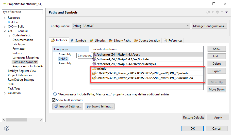

I try to debug the ethernet example on the mpc5748g, and have the same problems with https://community.nxp.com/thread/434962, but when I try try to adjust the route, the project still can not run. I do not know why those files can not be found, how to solve this problem?

PetrS
I tried to modify the path as stated in the thread you mentioned and it finally compiled without error in S32DS Power 2017. Do it for both assembly and GNU C languages.
BR, Petr

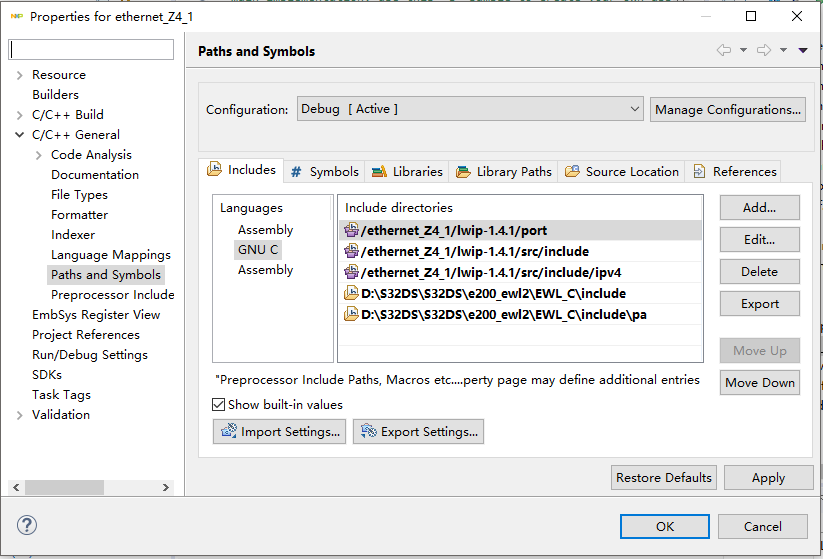

961271210
Hi Petr,
I change the route as same as you. But it still cannot find those head files.
The route which I use is as follows:
What should I do......?
Jupeng

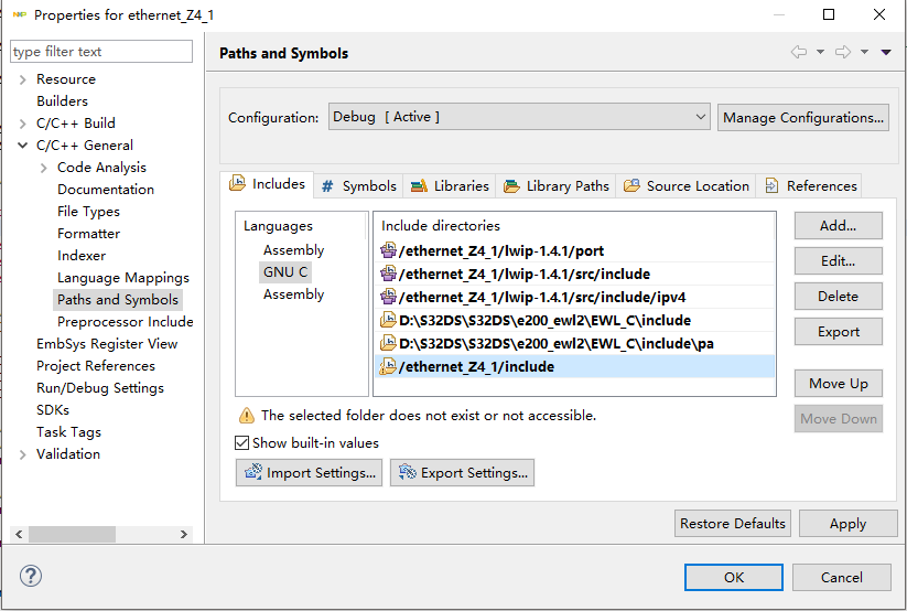

PetrS
you should add project's "include" directory too.
BR, Petr

961271210
I add the project's "include" into the path such like that, there are not any errors but S32 tells me that it cannot find my device. What does it mean?

PetrS
check updates from S32 and P&Emicro sites within S32 Design studio.
Also be sure proper debug interface is selected within project.
BR, Petr

961271210
But this problem just happen after I add the project's include, when I delete this path, the problem will disappear. And other projects do not have this problem.
