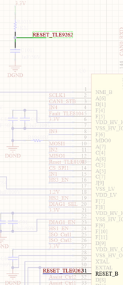

For the RESET_B reset pin of SPC5744, part of the boards do not work after the circuit is powered on, and the abnormal reset voltage measured is only 1.1V. The reset circuit is used the RC reset. Has this ever happened to any of you?
The reset circuit is like this :

Circuit board is the customer board, has been produced thousands of pieces, the production process has found a dozen pieces of board appeared this problem.
The reset circuit on the board uses RC reset circuit, just like what I wrote in the post, the resistance is 5.1K connected to 3.3V power supply, the capacitance is 1nF.

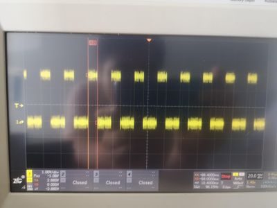

Later, the oscilloscope was used to test the working condition of the reset signal, and it was found that the reset signal of the MCU with problems after power-on had been doing the reset action repeatedly.

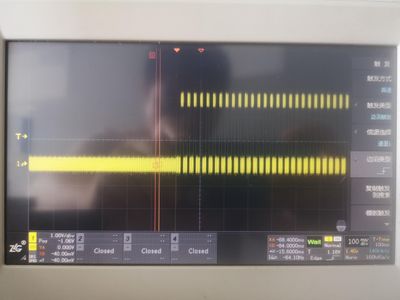

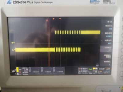

The waveform of the reset signal in the case of problem MCU is as follows:

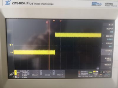

The waveform of the reset signal in the case of normal MCU is as follows:
From the photos it looks to me like the reset escalation cause by unhanded reset source.
Since your device will get out of reset for a while and then it will reset again.
What is the content of your RGM [FES/DES] when you attach to failing device. I see that reset is toggling so you must be able to attach to running target and break the code.
One more thing you can do it to place failing micro into the EVB and run some NXP reference code on it.
But this looks like application corner case issue to me. We will be wiser after RGM is read.
