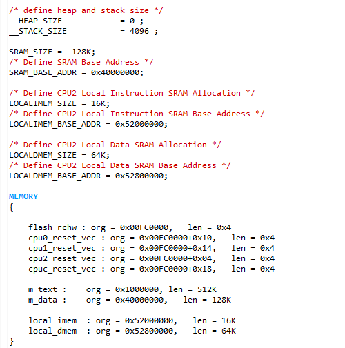

I make a bootloader for MPC5777M, which can recv hex file and upgrade code to flash.
But the bootloader can't jump to app.
#define APP_StartAddr (*(uint32_t*)0x00fc4004)

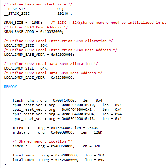

I tried like this, but it doesn't work:
#define APP_StartAddr (*(uint32_t*)0x1500000)

the bootloader link file:
the app code link file:
when i debug it, the debug info is as follow:

lukaszadrapa
is address in this definition correct?
Could you double check? This should work if the address is correct. Try to step the asm code to see what happened, which address was loaded and where it jumped.
