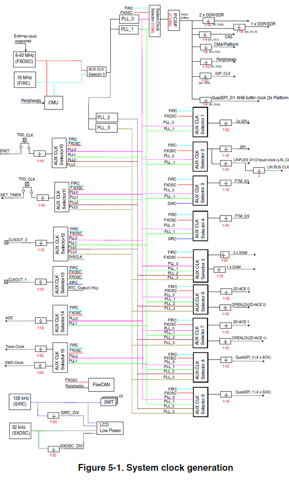

I cannot find out MAC57D54 PLL power supply in datasheet and RM , would you please supply reference document?
761 Views
jacky_Tan
MAC57D54_clock.pngwhich power pin is provioded power supply for this clock sysytem?

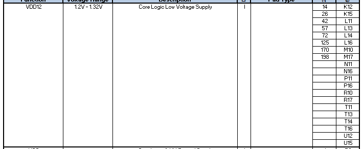

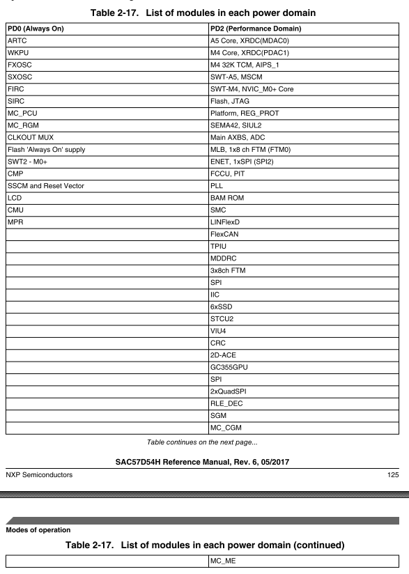

Hello Jacky,
please check the table below:
Martin

Hi Martin,
Thanks you answer my question.
Desay need know which pins supply SAC57D53HCVMO(516 MAPBGA package)PLL Power and Ground pin.
Would you help me point out the power supply pins for PLL power and Ground as below ?

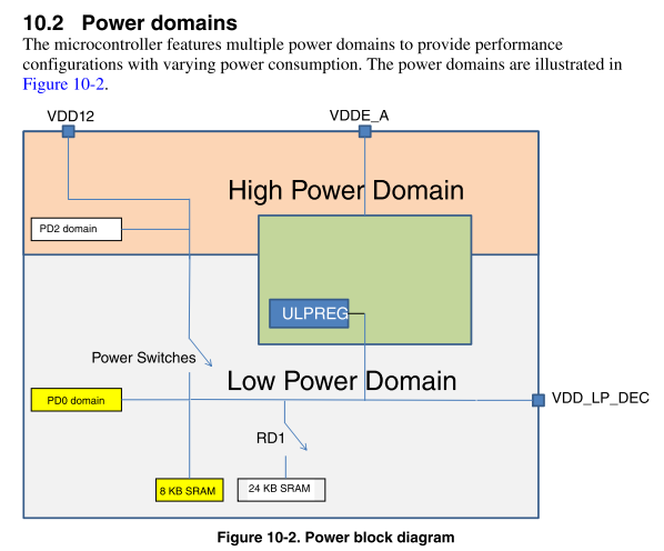

martin_kovar
please see the figure below. It shows, which pins supply which power domain.
These pins above are the ones. All these pins must be connected and it is not possible to tell, which pins supply which module. It works like one complex thing.
Hope it helps.
