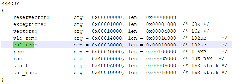

   My mcu type is MPC5642A, and below is memory layout from linkfile.
   I have a questions:
   How to assign constant variable to cal_rom region?
    thankyou very much!

here is an example:
In linker file:
MEMORY
    my_flash:  org = 0x003C0000,  len = 0x00040000
SECTIONS
    .__my_flash LOAD (0x003C0000): {} > my_flash
In *.c file:
#pragma push
#pragma section const_type ".__my_flash" ".__my_flash "
uint32_t a;
uint32_t b;
uint32_t c[10];
#pragma pop
Notice that you can use const_type or sconst_type or all_types in “#pragma section”. Here is the description from CodeWarrior:
- code_type - executable object code
- data_type - non-constant data of a size greater than the size specified in the small data threshold option in the EPPC Target settings panel
- sdata_type - non-constant data of a size less than or equal to the size specified in the small data threshold option in the EPPC Target settings panel
- const_type - constant data of a size greater than the size specified in the small const data threshold option in the EPPC Target settings panel
- sconst_type - constant data of a size less than or equal to the size specified in the small const data threshold option in the EPPC Target settings panel
- all_types - all code and data
Lukas
