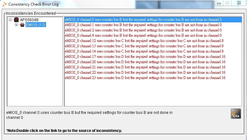

I used RAppiD to configure 5604B
I want 12 input capture channels  to receive signal
But I got 12 error after I configure  settings
I have no idea how to solve " counter bus B are not done in channel 0 "
Dose It mean that  I can't use 12 input  capture channels ?
Thank you very much !

I am not familer with RAppID, but probably you selected local counter bus (BSL=1) for individual eMIOS channels and channels that serve counter bus B (ch0), C(ch8) and D(ch16) do not enable prescaler and are not set for MCB mode.
Try to select counter bus A (BSL=0) for individual input channels and confige ch23 to serve counter bus A, set it for MCB mode.
BR, Petr

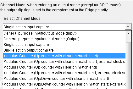

I can't use channel 23 (serve counter bus A (ch23)) .
Ch23 have to set  for Modulus Counter (counter Bus [A]).
Next, all of the SAIC channel  select  counter Bus [A].
BR, Kevin
