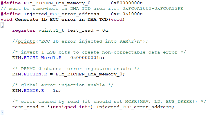

Hello, I encountered a problem in the process of testing 5744: MEMU_PERIPH_RAM_CERR,MEMU_PERIPH_RAM_UNCERR injection failed to make the MEMU_ERR_FLAG register PR_CE,PR_UCE set, the test code is downloaded from the NXP website. At the end of the main function injection, the code is as follows:
#define EIM_EICHEN_DMA_memory_0 0x80000000u
// must be somewhere in DMA TCD area i.e. 0xFC0A1000-0xFC0A13FE
#define Injected_ECC_error_address 0xFC0A1000u
void Generate_1b_ECC_error_in_DMA_TCD(void)
register vuint32_t test_read = 0u;
//printf("ECC 1b error injected into RAM\r\n");
/* invert 1 LSB bits to create non-correctable data error */
EIM.EICHD_Word1.R = 0x00000001u;
/* PRAMC_0 channel error injection enable */
EIM.EICHEN.R = EIM_EICHEN_DMA_memory_0;
/* global error injection enable */
EIM.EIMCR.R = 1u;
/* error caused by read (it should set MCSR[MAV, LD, BUS_DRERR]) */
test_read = *(unsigned int*) Injected_ECC_error_address;

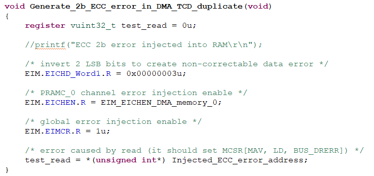

void Generate_2b_ECC_error_in_DMA_TCD_duplicate(void)
//printf("ECC 2b error injected into RAM\r\n");
/* invert 2 LSB bits to create non-correctable data error */
EIM.EICHD_Word1.R = 0x00000003u;
EIM.EIMCR.R = 1u;
note: FLASH_RAM,SYS_RAM can use NXP Web site code to implement error_injection.
Thank you very much for your help!
I am sorry but I don't understand you. Could you clarify what exactly does not work for you? Thanks
Hello David ,
      1b+2b_PERRAM_ECC_error_injection doesn't work in my main function,PR_CE and PR_UCE of MEMU_ERR_FLAG register are always zero,my chip is SPC5744PFK1AMLQ9,the 1b+2b_PERRAM_ECC_error_injection code that injected into the main function is as the follows pictures:
      Thanks for your help!!
