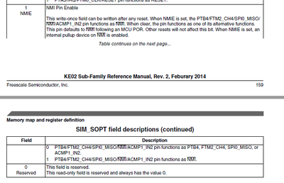

We observe when we connected debugger PTB4 IS HIGH SIDE DRIVE (PWM_BH)FTM2_CH4 IS WORKING GOOD.
After reset the debbuger and power supply, and switch ON SUPPLY ,we found that When we touch fingure to the pin of PTB4  this become ON . WHY AND HOW TO RESOLVE PLEASE SUGGEST
762 Views
xiangjun_rong
For KE02, the PTB4 is multiplexed with NMI, I suppose that after reset, the chip enters NMI ISR.
Pls connect a pull-up resistor to the PTB4 pin.
Secondly, I suggest you clear the NMIE bit with the line:
SIM->SOPT&=~(1<<1);
Pls have a try
