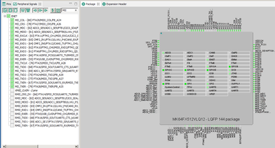

I have created new project, configured Ethernet pins for MII, added LwIP and then added an interface based od ENET using + button. I have tried to remove interface and add it again, but still only RMII option is visible.
Is the MII interface option emabled by some other settings, that must be correctly set? I.e. clock? Pins?

TomaszOzon
Hi @CarlosGarabito
> This clock is used as the timing reference for the external MII or RMII interface.
OK, so what I need to configure to enable MII/RMII selection? For MII I don't need any external clock, only MII_TXCLK and MII_RXCLK from PHY to MAC. They are already configured and I still can't select MII.

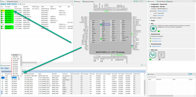

Hi @TomaszOzon on MCUXpresso, on config tools, you can help you with this.
I hope this help you

Hi @CarlosGarabito
I think my pins configuration is fine (and it was before). Please have a look.
Maybe you could create a project for this microcontroller with MII pins configured and then check if MII option is available for LwIP+ENET?

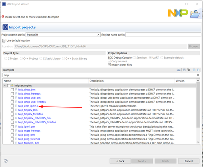

Thats right, in MCUXpress you can select the example
Go to config tool, modify
So, you can find it
And test it
