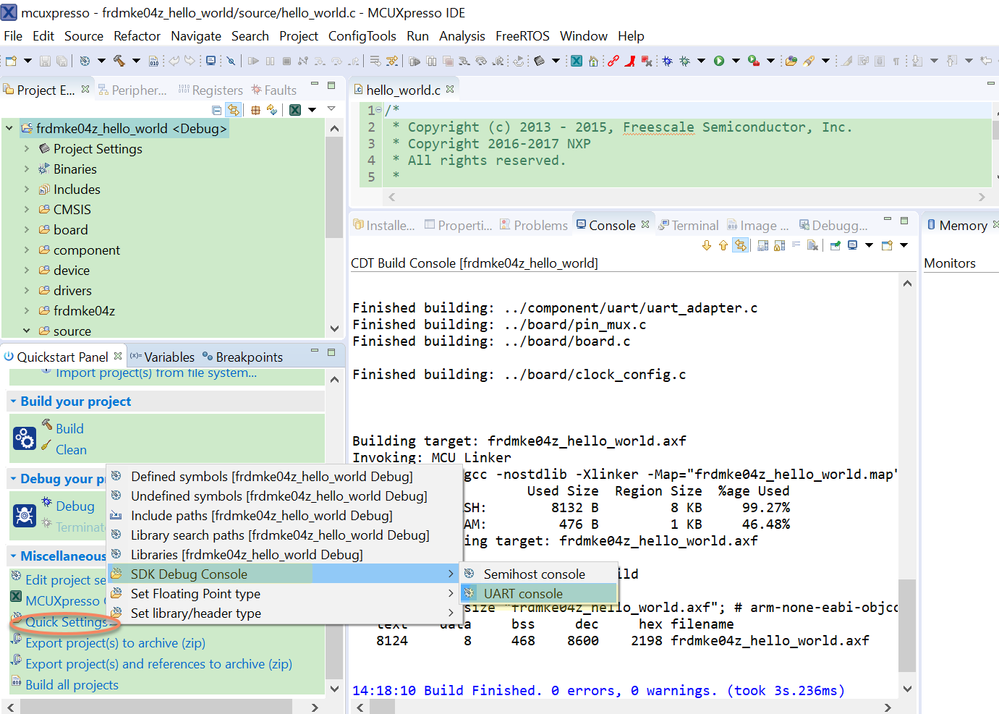

I have a FRDM-KE04Z development board. I've installed the MCUXpresso and downloaded the SDK for the FRDM-KE04Z board. I imported it into the IDE without any issues.
I wanted to compile it to make sure that everything was setup correctly and I ran into a linker error. I've attached the error. It appears that it is attempting to take up to 150% of the Program Space. This is unmodified SDK from the NXP site, so maybe I imported something incorrectly.
Has anyone else seen this issue previously? Any thoughts on what might cause this from a demo SDK. Thanks for the help.

  Seems you select the semihost console, not the UART console, semihost will consume more flash.
  Please change your SDK debug console to UART, then try it again, your issue may be solved:
Please check it.
If you still have issues, just kindly let me know.

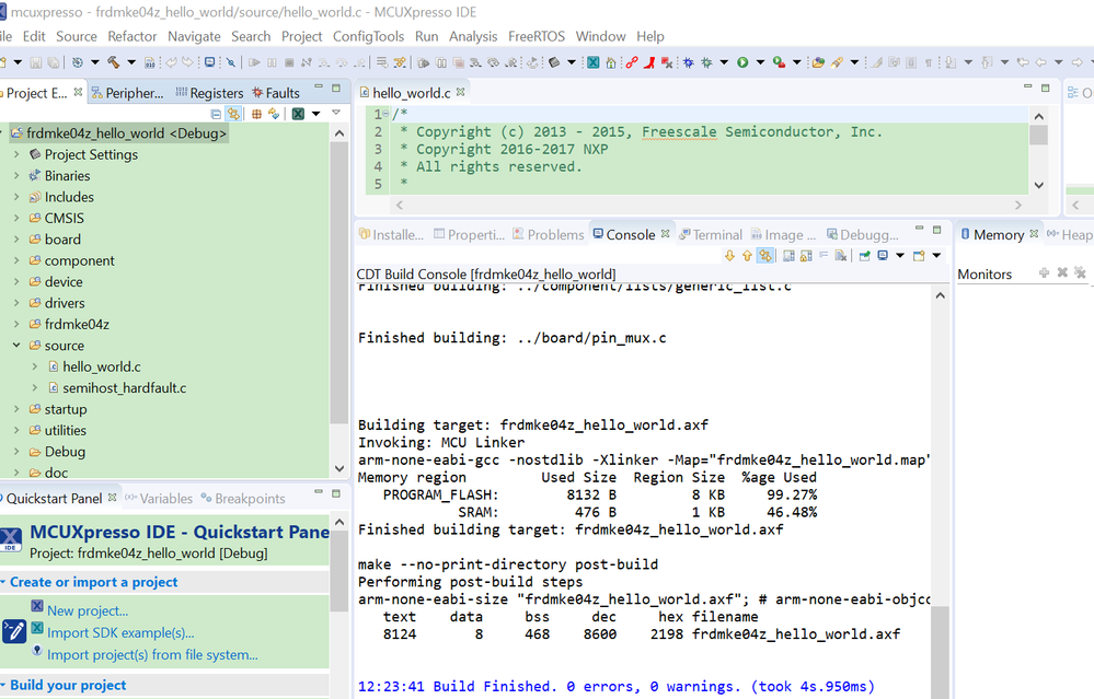

  Today, I import it to my MCUXPresso IDE:
   But you need to note, the FRDM-KE04 is the small flash, just 8KB, so you also need to check the code, if the code is really larger, it may large than the flash size.

  In fact, I just download the newest SDK, then use the MCUXPresso IDE import the helloworld project, then do nothing, the IDE didn't overflow, without any modification, that's why I ask you, whether you are using the newest SDK or not.
  Do you try the SDK2.8.0, the same result even just import it?
  Which MCUXpresso IDE version you are using now?  My version is: v11.1.1
  Do you use the release version or the debug version in the SDK project?
  The SDK code in default should not have your issues. Any modifications on your side?

I have MCUXpresso v11.2.0 Build 4120. I didn't make any modifications to the Source code.
When I do the Debug build, the build report has 11652B of the 8KB used (142%).
When I do the Release build, the build report has 9292B of the 8KB used (113%).

Thanks kerryzhou‌. That worked. I didn't realize that this would change based upon a setting. I thought that this was taken care of in the DebugConsole() call. It builds now. Debug build uses 8132B (99%) of the device.
2,403 Views
