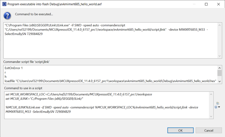

jingpan
In GUI flash tool, there is Preview command option. Select this option to be presented with a preview programming command to be issued and a script that can perform this action independently of the IDE.
Please try to add script here.

I tried your suggestion and unfortunately it gives the same error message, see below. Did I miss something or make a mistake somewhere?
script.jlink contents:
ExitOnError 1
r
h
w4 0x400AC040,0x00200007
w4 0x400AC044,0xaaaaaabb
w4 0x400AC038,0x00a70000
loadfile "C:\mcuxpresso_ws_11p4\XXXXX\Debug\XXXXX.hex" 0x60000000
qc
qc
