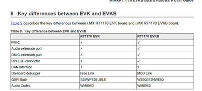

Hi, is there a document somewhere that outlines what Errata are fixed in MIMXRT1170-EVKB (vs. MIMXRT1170-EVK)?  A design we have in process was originally based on the MIMXRT1170-EVK and I want to make sure that we incorporate any fixes in MIMXRT1170-EVKB.  Also, code that we had compiled for the EVKB is not running at all on the EVK so we'd like to know what the specific hardware differences are.
2,736 Views
anthony_huereca
Here are the differences between the i.MX RT1170  EVK and i.MX RT1170 EVKB:
There is a EVKB Hardware User Guide that includes this table coming out soon. It is recommended that any new users to RT1170 use the EVKB board as it is the newer board and includes more features as you can see above.
Also per the original question, make sure to download the correct SDK for your version of the board:
i.MXRT1170 EVK: SDK_2_14_0_MIMXRT1170-EVK
i.MX RT1170 EVKB: SDK_2_14_0_MIMXRT1170-EVKB
