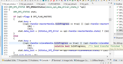

There seems to be an error in fsl_spi_cmsis.c in SPI_InterruptGetStatus(): To my mind the busy flag in the ARM_SPI_STATUS RETURN is set opposing to what I would expect. It will be set to "0" if there is still data to be transmitted or received.
(Same issue in SPI_GetDMAStatus() ..)

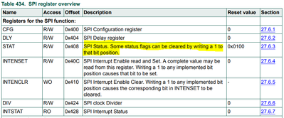

Related with the SPI_InterruptGetStatus(). If you look closely in the LPC540xx/LPC54S0xx User manual; Chapter 27: LPC540xx/LPC54S0xx Serial Peripheral Interfaces (SPI); you will see that the SPI Status register (STAT), specifies that some flags actually can be cleared by writing a 1.
And related with the SPI_GetDMAStatus(), if you click or let the cursor in txInProgress or rxInProgress, you will be able to see that actually the flag is setting with a 1 when the transfer is active (busy), and clearing with a 0, when the transfer ends.

But I still think that in both of the "getStatus"-Routines SPI_InterruptGetStatus() and SPI_DMAGetStatus() the stat.busy flag returns just the opposite: The code says
"if either TX is in progress OR RX is in progress the SPI is not busy" (stat.busy is set to 0)
according to your explanation and my understanding it should be:
"if either TX is in progress OR RX is in progress the SPI is busy" (stat.busy should be set to 1)

I apologize for the misunderstanding. The stat.busy in both functions GetStatus (DMA and Interrupt) is setting to 0 when SPI is busy.
  • (SPI_InterruptGetStatus)txRemainingBytes and rxRemainingBytess will decrease its value until it ends the transfer.
  • (SPI_DMAGetStatus)txInProgress and rxInProgress will be True during the transfer, and False only when the transfer ends or aborts.
So, as you say, stat.busy will be 0 while SPI communicates, and 1 when doesn't.
