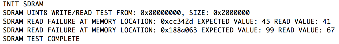

I have written an example application that is initializing and using the SDRAM on the RT1052-EVK.
The program should be executing directly from flash using the xip driver.
The problem is that when I perform a write/read test of the full 32M SDRAM, there are consistently a few addresses that have been changed outside of my execution logic.  The same addresses are incorrect across multiple debug sessions, so I assume they are changed programmatically.
I initialize the SDRAM in my code, but I see some online references that indicate that the debug connect still initializes SDRAM itself (even when using xip?).  I don't see any connect script specified for the debugger (in this case the OpenSDA linkserver)
If SDRAM is initialized by the debugger, I was trying to determine what the SDRAM memory section was being used for outside of my main execution, and if this could possibly be what is changing SDRAM.
Attached is my memory section config, my linker settings for heap/stack and an example of some addresses that fail the test.

OK, I went through the SDRAM init script and made some minor changes to the semc_config in my example, as well as some changes to the pin configs, but with similar results: memory reads would fail at a few specific locations.
These failure locations seemed to be related to the type of PRINTF debug being output.

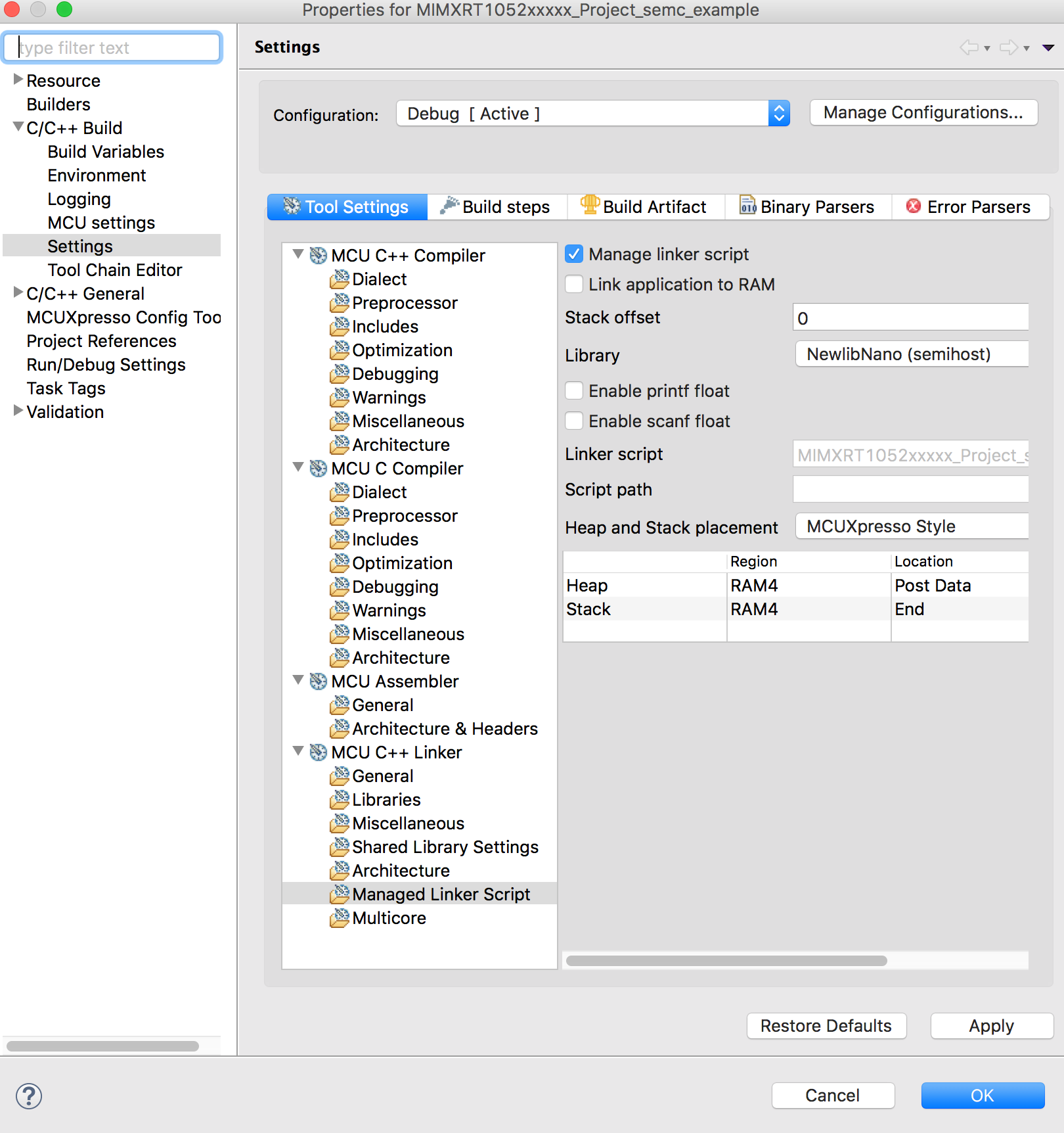

Then I totally removed the SDRAM memory section (RAM3) from my project and the LinkServer debug output started acting strange/garbled.  My test array uses a pointer to the correct SDRAM address, so it should not need the memory section defined.
I switched to using a J-Link and it worked as expected and the SDRAM test ram without failure (?!)
So it seems that the DAPLink-LinkServer debugger is using the SDRAM memory in some way that is impacting the ability to use the full 32MB for data.  Ideas?

I see data and bss sections are being allocated to SDRAM in the map file, so I suspect that it is placing something in SDRAM besides only my data. I placed HEAP and STACK in a different region in the managed linker settings, but it didn't seem to change the behaviour, but I admit I am not very familiar with MCUXpresso IDE at this point.
