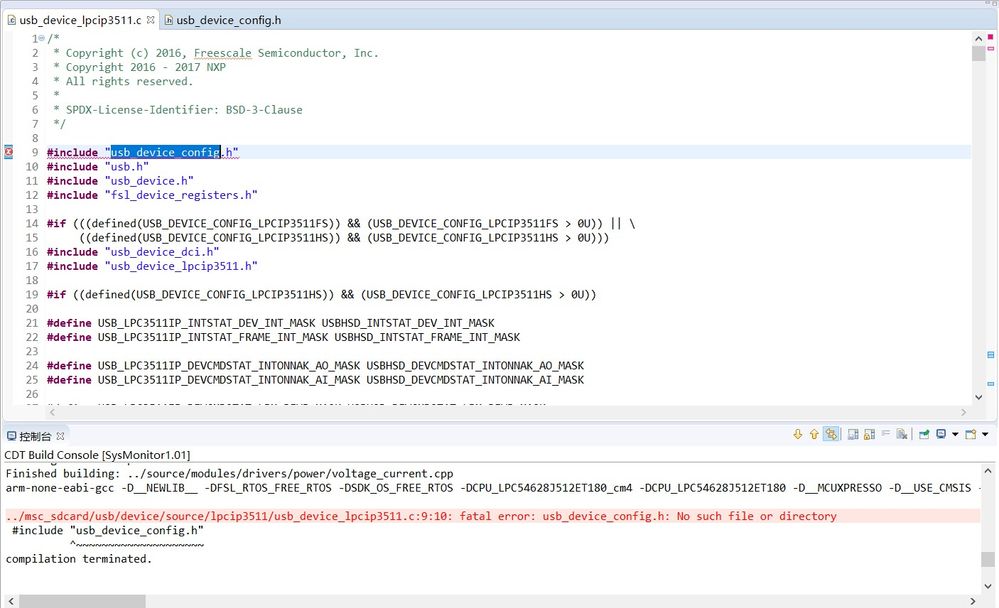

hello everyone.

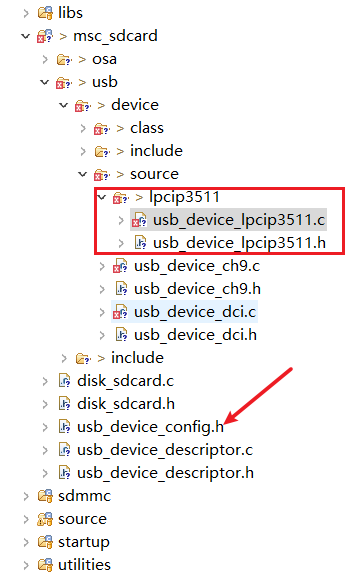

   I have a question,I add new file,The compiler prompt could not find the header file,I check include path,I am sure add path is OK,use open declaration also find it.I do not know Why?path_setting.jpg

Would you please attach the complete build log? I can't tell from the screenshot what's been passed along with "-I".

hello,I try many times,I find the problem。I use the C++ project,it must add the C code path in the "MCU C Compiler-->>Includes",although I also add C code in the "MCU C++ Compiler-->>Includes".I found it was a setup problem.Thanks!
