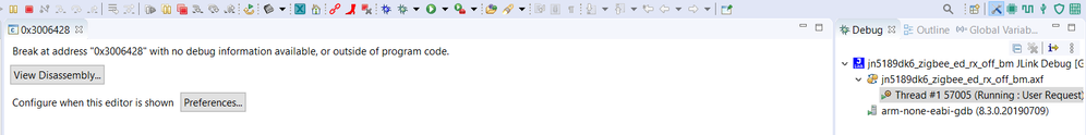

I experience a problem while using MCUXpresso (v11.2.0_4120) and I try to debug any code (Demo software or not) using J-Link debugger on JN5189 chip (SDK_2.6.0_JN5189):
Debugger gets stuck at a weird address which seems to be outside of program code and it doesn't even reach main function.
Please check picture below.
Anyone had a similar issue or knows a fix for this ?

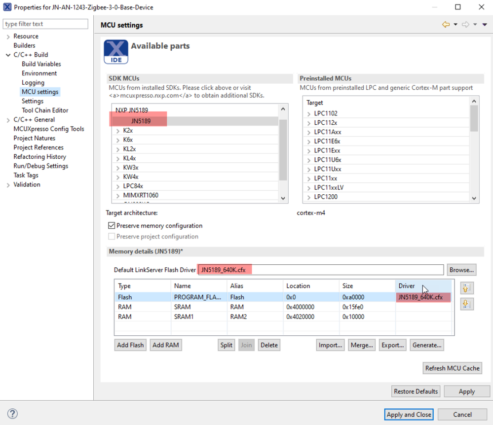

  • The MCU Settings must be configured to use the JN5189 driver:

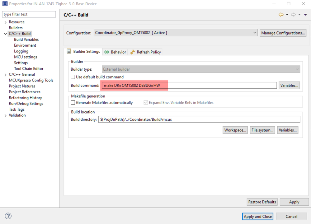

  • In the project's settings, please add the following build command to the options:
DEBUG=HW
Like so:

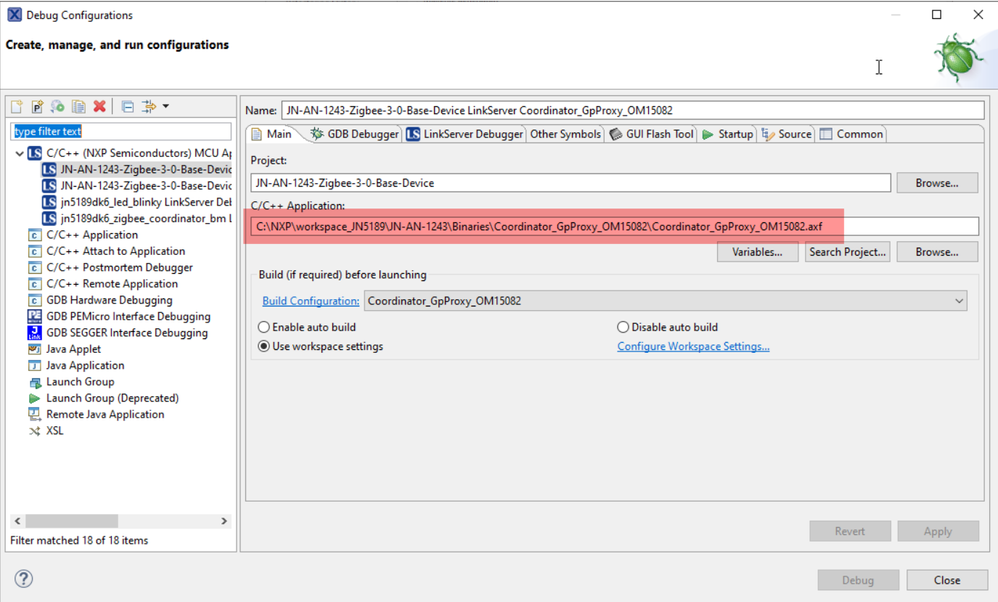

  • And finally, the compiled .axf file needs to be selected in the debug configuration:
Note: Be sure that the JP4 and JP7 are shorted as 3-4 on the board.
