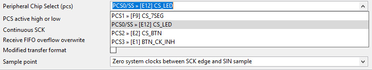

In MCUXpresso's Config Tools, when configuring a DSPI module to use a particular pin for the Peripheral Chip Select, the drop down menu displays the custom Pin Labels I have defined in the Pin tool (see below):
In the generated code, I am unable to find any sort of mapping between my custom Pin Labels and the enum _dspi_which_pcs_config which is used to select the Chip Select when passing a dspi_master_config_t along to DSPI_MasterInit().  However, the generated initialization routine properly uses kDSPI_Pcs0 as the dspi_which_pcs_t, since that is somehow linked to my CS_LED pin.
Does this mapping exist explicitly somewhere (for example, through some #defines), so that the PCS can be changed during execution by using my custom Pin Labels? I could obviously manually create this by writing something like:
#define PCS_LED kDSPI_Pcs0
#define PCS_7SEG kDSPI_Pcs1
etc.
but it seems that Config Tools is already creating this mapping somewhere, I'm just unable to find it.

Hi Alice,
I am using the MK64FN1M.
Attached is a project demonstrating my question. I have configured the pins and SPI peripheral as shown in the original post.
In the .mex file, you can see that I have chosen PCSO/SS >> [E12] CS_LED as the Peripheral Chip Select.
In the generated peripherals.c, it generates a dspi_master_config_t with the .whichPcs variable set to kDSPI_Pcs0. This is all correct.
However, I can not find a clean and clear way to change the .whichPcs during program execution using the custom labels I have provided to the pins, unless I manually go back into Config Tools to see the mapping between the pin labels, and the DSPI PCS enumeration.

Hello Andy,
The definition of kDSPI_Pcs0 is in the file of "fsl_dspi.h":
and the "Label" is not used to here. About the description about Label you can have a look at this thread:
Config Tools Pin Label and Identifier
