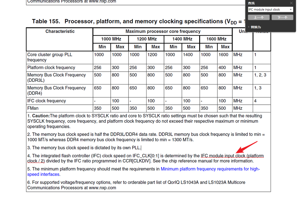

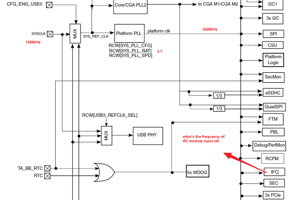

in the codewarrior, why do I set platform clk : sys_clk ratio = 3:1, the platform clk is 200MHz? my physical sys_clk is actual 100MHz, where to change sys_clk input in the code warrior?
in the manual reference,  does the IFC module input clk equal to the paltform clk?
in the datasheet, there's a notice in the below, does the IFC module input clk equal to half of the paltform clk?:
426件の閲覧回数
ufedor
In the Data Sheet it is written "IFC module input clock (platform clock / 2)" - "/ 2" is a typo.
Correct:
IFC module input clock (platform clock)
