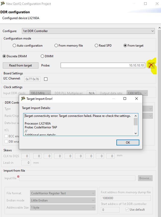

we ran DDR memory tests on a custom lx2160a board with 32GB DDR4 arranged with 16GB per Memory controller with Rank0 and Rank 1 per memory controller.
We ran memory test using code warrior QCVS tool did the memtester stress testing. Both the memory controllers are passing all the tests.
mtest is failing with ECC errors and even causing the crash when run from u-boot
memtester is also causing kernel crash when run from Linux.
Attaching logs for mtest failures.
what could be the reason ?

saidivvela
yes we are modifying atf source code in atf/plat/nxp/soc-lx2160a/lx2160ardb/ddr_init.c to configure our DDR.
We defined CONFIG_DDR_NODIMM and modified the struct dimm_params ddr_raw_timing with the parameters from codewarrior project generated code.
yes we used the same RCW on the target board when using atf and QCVS tool.
While reading from the target method to create a QCVS DDR project I see Target import error.
239 Views
yipingwang
Would you please capture CCS log to me to do more investigation?
When you click "Read from target" button, CodeWarrior Connection Server(CCS) will pop up in the right bottom of your Windows task bar, please double click it to open the console and type command "log v", then click "Read from target" button again, the low level CCS log will be printed in the console.
94 Views
saidivvela
Read from target worked after resetting codewarrior TAP .
Will update with the log if I face the similar error again.
Thank you.
