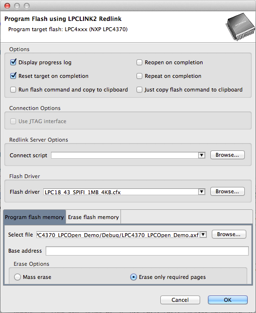

Within the flash programming tool, you can then choose to program an image into the flash...

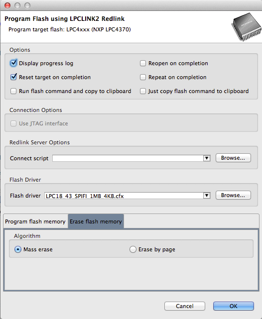

or by selecting the other tab, you can choose to erase the flash....

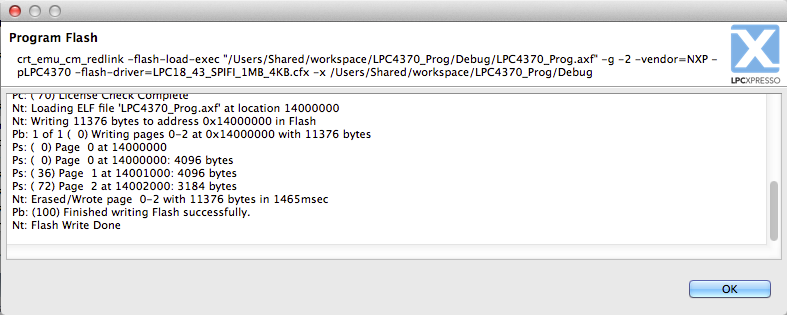

Generally it is also a good idea to ensure that the "Display progress log" option is enabled before programming/erasing. This will cause details of the operation to be displayed once programming completes - as below.
