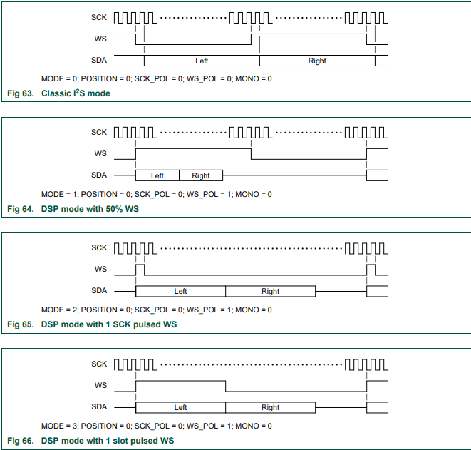

what is the Frame format of I2s(integrated sound).

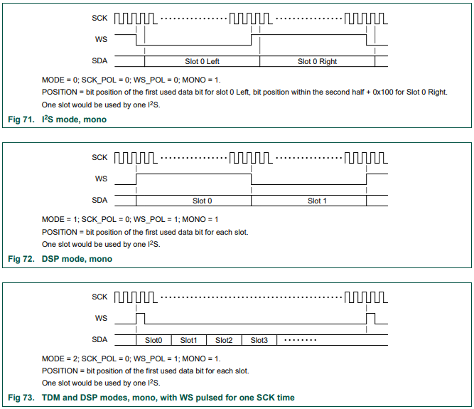

A sampling of frame slot formats are shown in the following figures. This is not an exhaustive set of possibilities, but shows the various frame formatting concepts. Note that slot identifications are illustrative only, data positions are flexible and there are no predefined slots for the hardware.
You can find more information in the following link:
https://www.sparkfun.com/datasheets/BreakoutBoards/I2SBUS.pdf
