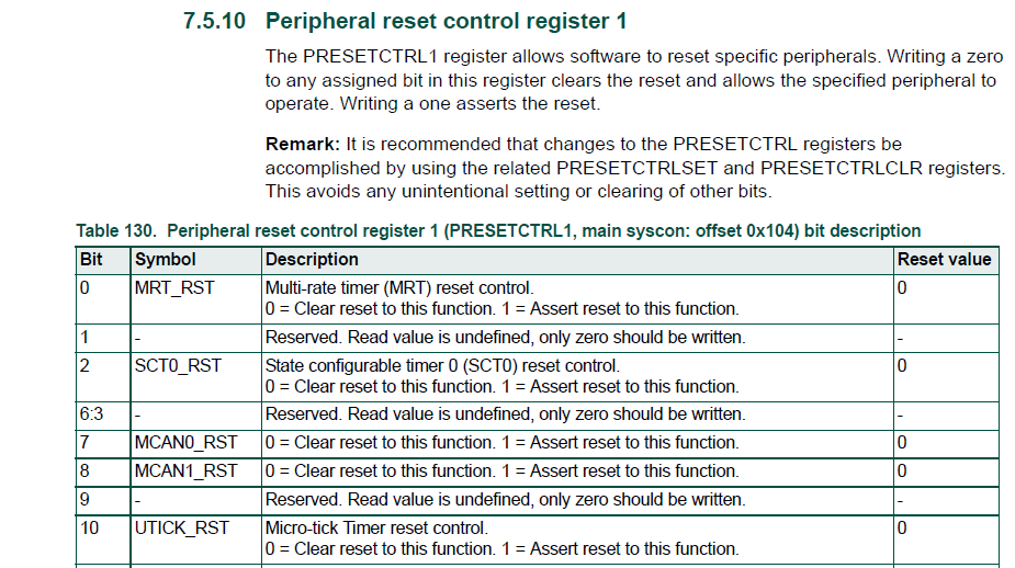

xiangjun_rong
Hi, Ali,
I see that you just want to handle various error.
You can manipulate the NCAN0_RST in PRESETCTRL1 REG to reset the CAN module, then reinitialize the CAN module.
Hope it can help you
XiangJun Rong
