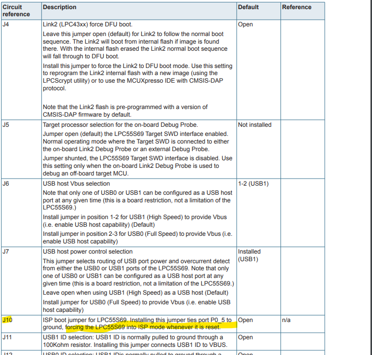

didi you try placing jumper J10?

Hi Raymundo,
Thanks for your reply. But I have tried this. The chip cannot enter ISP mode.
It gives no response to blhost
