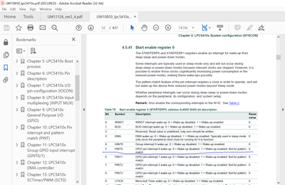

I am trying to figure out why my custom board doesn't wake up and I was looking at the lpcxpressor54102_power_manager_lpc example.
Part of the example is the API_InitWakeupPin() function that has this code:
    /* Configure the Input Mux block and connect the trigger source to PinInt channle. */
    INPUTMUX_Init(INPUTMUX);
    INPUTMUX_AttachSignal(INPUTMUX, kPINT_PinInt0, APP_USER_WAKEUP_KEY_INPUTMUX_SEL); /* Using channel 0. */
    INPUTMUX_Deinit(INPUTMUX); /* Turnoff clock to inputmux to save power. Clock is only needed to make changes */
    /* Enable wakeup for PinInt0. */
    SYSCON->STARTERSET[0] |= APP_SYSCON_STARTER_MASK; /* GPIO pin interrupt 0 wake-up. */
    /* Configure the interrupt for SW pin. */
    PINT_Init(PINT);
    PINT_PinInterruptConfig(PINT, kPINT_PinInt0, kPINT_PinIntEnableFallEdge, pint_intr_callback);
    PINT_EnableCallback(PINT); /* Enable callbacks for PINT */
    EnableDeepSleepIRQ(PIN_INT0_IRQn);
Granted, I haven't been able to get it to work yet, but the line with SYSCON->STARTERSET[0] does not appear to be correct to me.  APP_SYSCON_STARTER_MASK is 0x4U which would cause a reserved bit in STARTERSET[0] to be set.
The EnableDeepSleepIRQ() function called at the end of the code sets the STARTERSET[0] PINT0 bit and enables the Int0 interrupt which does appear to be correct.
Is this an error in the example code?

For some odd reason I don't understand, I had to set the 12 MHz clock right before going to sleep.  It wakes up now.

Hi, James,
For the above code, this is the definition:
#define APP_USER_WAKEUP_KEY_INPUTMUX_SEL kINPUTMUX_GpioPort0Pin24ToPintsel
In other words, the example uses PIO0_14 pin to trigger PINT0 pin interrupt via input_mux module.
Pls check which pin you are using to trigger the PINT0 interrupt for your application. For example, if you use PIO0_1, you can use the code:
INPUTMUX_AttachSignal(INPUTMUX, kPINT_PinInt0, kINPUTMUX_GpioPort0Pin1ToPintsel);
For the second line:
#define APP_SYSCON_STARTER_MASK SYSCON_STARTER_PINT5_MASK
I suppose it is incorrect, the if you use PINT0 to wake-up from deep-sleep mode, pls try to use the line:
SYSCON->STARTERSET[0] |= SYSCON_STARTER_PINT0_MASK; or
SYSCON->STARTERSET[0] |= 0x20;
Hope it can help you
XiangJun Rong

The STARTERSET register is set in EnableDeepSleepIRQ():
void EnableDeepSleepIRQ(IRQn_Type interrupt)
    uint32_t intNumber = (uint32_t)interrupt;
    uint32_t index = 0;
    while (intNumber >= 32u)
        index++;
        intNumber -= 32u;
    SYSCON->STARTERSET[index] = 1u << intNumber;
    EnableIRQ(interrupt); /* also enable interrupt at NVIC */
