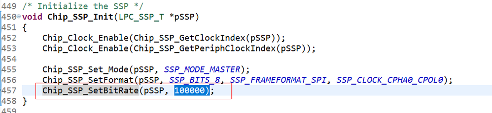

Hello John DeMar,
I'm afraid that if I understand your meaning correctly,
About "Pin Interrupt to respond to the ADC ready line to start the transfer, The interrupt is happening at 60KHz when I simply toggling a pin" - > Once the ADC data ready, there is a pin interrupt , the frequency is 60MHZ. While the DMA trigger frequency <8MHZ, right ?
If yes, you need increase the SSP clock rate ,  please check it  on your side . On the demo code " periph_ssp " ,   the bit rate is 100K.
Hope it helps,
