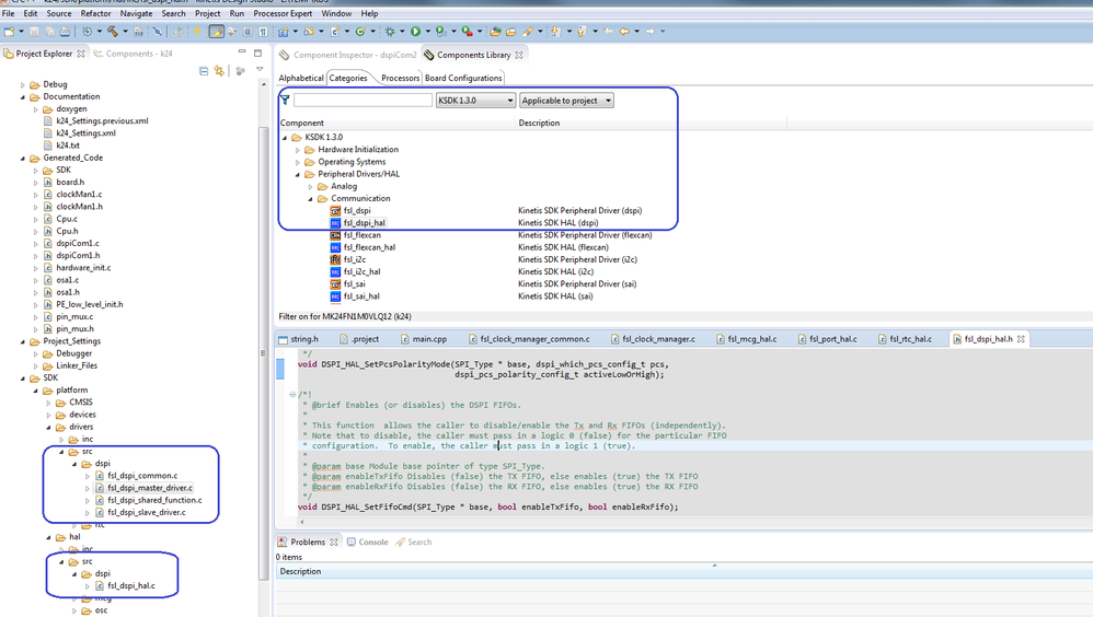

hi,
it seems that the driver and HAL source code of spi in the KSDK v1.3.0 Mainline releases is fit Kinetis KL serial rather than Kinetis K serial.is there any driver and HAL source code about spi that fit Kinetis K serial?for example,MK24.
thanks.
748 Views
TICS_Fiona
Hello ruiye
SDK v1.3.0 includes the SPI driver and HAL source code for K24, you can find it after enable the PE’s fsl_dspi, fsl_dspi_hal component.
