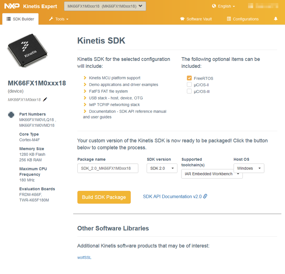

Can someone  please send me the link to download for  MK66FX1M0VL
338 Views
ivadorazinova
Hi manu,
please did you get to this page Welcome to Kinetis Expert | Kinetis Expert ?
For this moment, SDK 1.3 and 2.0 are downloaded from this website.
just choose OS, toolchain and version of your Operation System and Build SDK Package.
Please let me know, if it works you.
Iva

And also plz let me know how to add this SDK into my existing software(KDS)
338 Views
ivadorazinova
Hi manu,
no, it does not work this way.
I recommend to you start with this guide: Getting Started with KSDK 2.0
If you have a project without KSDK, you should create new project with KSDK.
Please see Using Kinetis Design Studio v3.x with Kinetis SDK v2.0 chapter Creating and Debugging KSDK V2.0 Project
In case, you work with KSDK 1.3 and want to move your project to KSDK 2.0, please see the Transition Guide, Transition Guide for KSDK 2.0
Or you can easily start with KSDK demo, located under <ksdk2.0_path>\SDK_2.0_FRDM-K64F\boards\frdmk64f there are examples for RTOS, USB, DRIVERS and DEMO (examples as hello world, bubble, dac_adc, power manager etc).
To avoiding work with original examples, you can copy example with KSDK Project Generator ToolNew Kinetis SDK Project Generator v2 is available!
I hope this helps you.
In case of any question, please let me know.
