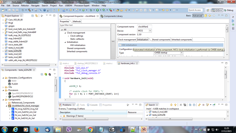

I noticed that Processor Expert doesn't generate a call to Clock System Initialization function inside "hardware_init" function. So, my question is, where is this called? Or it is not called anywhere and I must drag and drop into my code (what wouldn't make any sense to me, since it should be a Processor Expert role)?
When I place the mouse over "HW Initialization", KDS tells me the initialization of clock system is automatic and is performed via CMSIS startup, but where is this startup file, where is the call for a Clock Initialization function?
"hardware_init" and "PEX_components_init" functions are in grey, although "CPU_HARDWARE_INIT" and "PEX_COMPONENTS_INIT" macros are enabled:
The same ocurrs for "Components_Init" function, which doesn't have anything inside it:

Hello Marco Aurelio:
Clock initialization is made in the function SystemInit() from the file system_<device>.c. This function uses the macro definitions from the header file system_<device>.h.
System clock is initialized before reaching main. The initial configuration used is the one you select from the fsl_clock_manager component. See below an example:
In this case there are 6 clock configurations and the configuration 1 is used for the CMSIS startup code.
To dynamically change between clock configurations in your project, then you can use the Clock System APIs. See the next discussion in the community about this subject with an example project:
Change between clock configurations

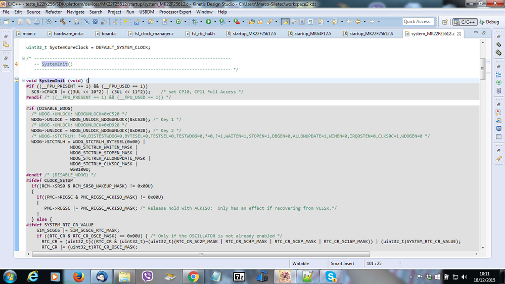

SystemInit function is all in grey. What should I do?
Have attached my code.
Thanks!

Jorge_Gonzalez
Hello Marco:
From my side it does not appear grayed out. It may be that the Eclipse indexer is having issues in your case. See if the next post by Erich helps you resolve it:
Fixing the Eclipse Index | MCU on Eclipse
So, I do not always trust in the grayed or not-grayed out code. Instead open a debug session and see what code is actually executed, or visually inspect the macros to see what code is valid.
Regards!
Jorge Gonzalez

MAPC
Senior Contributor I
Hello, Jorge
Yes! You hit the bull's eye!
After following Erich's tutorial, the grayed out areas became white. But, as you said, that is not an issue, since the code is executed in a debug session, even when it is in gray. What really matters is if the macro above the code is enabled or not.
Thank you Jorge and Erich very much for your efective support once again.
