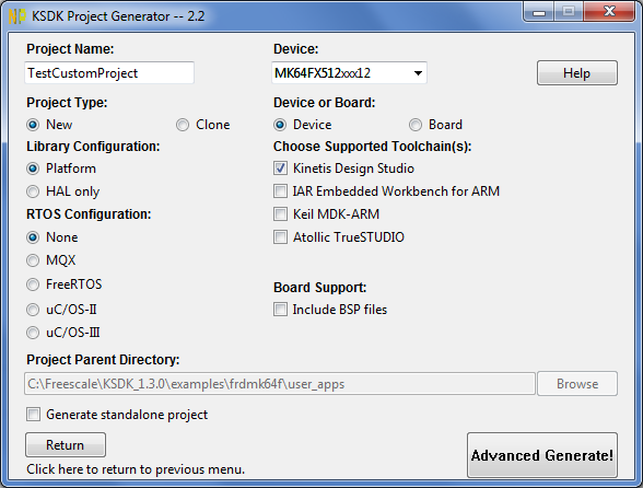

Just for the information - can you show me please your Project Generator configuration?
Please, do you use the newest version of Project Generator Tool 2.2 ?
I tested it on my side and it seems to be all right.

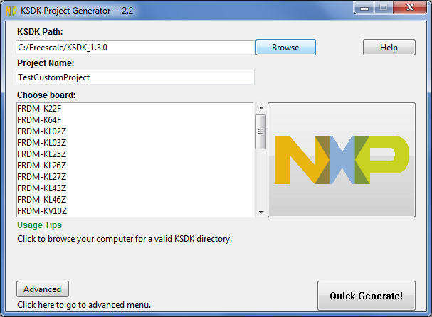

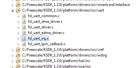

This is my configuration:
(I choose the FRDM-K64F option)

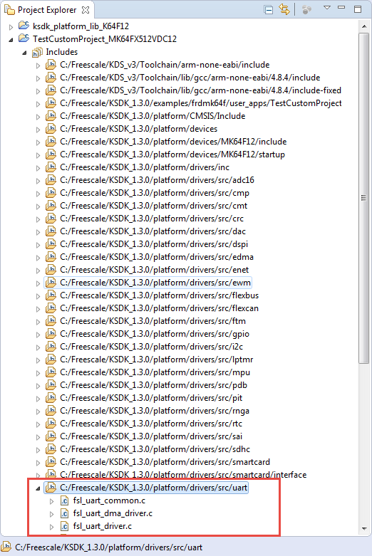

And import this project (according this procedure How to: import example in KSDK ) into KDS

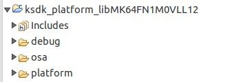

and there are included files in KDS - ksdk_plaform library and the project, which I created:

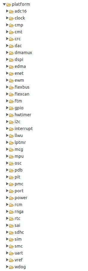

I see the drivers:

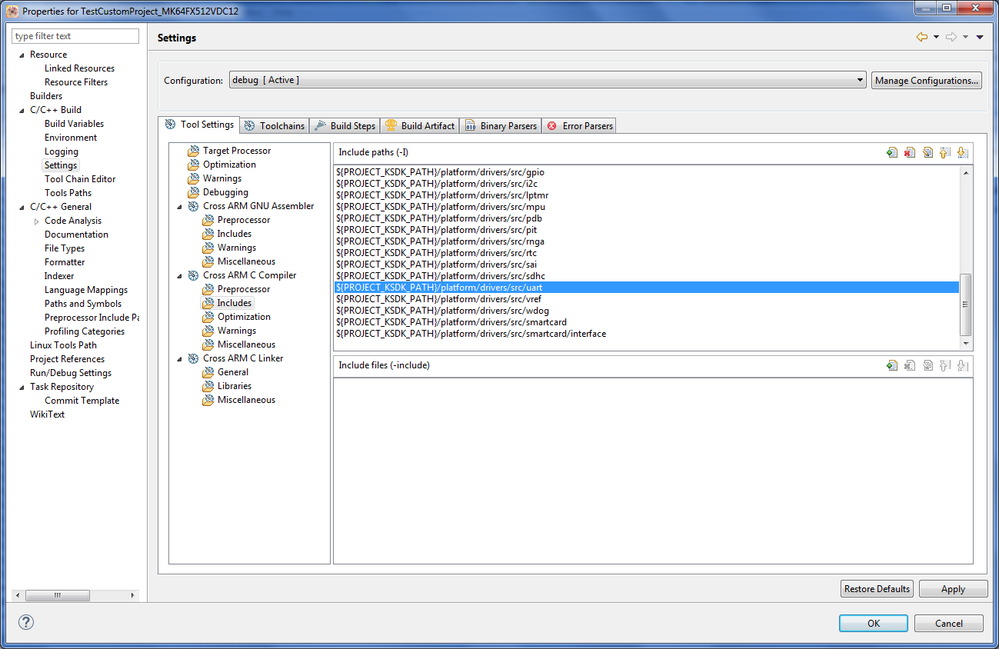

and Properties for the project :
Please let me know your results.

I've just checked the makefile, and it pointed out to the answer of my question. I can see that during the compile it calls the sources in. So I already know, how it works, but I still don't know, why are the source files among the includes.
1,483 Views
darnaiadam
First of all, thank you for your quick respond.
I checked the path you attached, but I can't understand, why are these source files within includes?
According to my idea there has to be a folder in the project, that contains the source files, like 'sources'.
Apart from this, I found the irq files I mentioned.

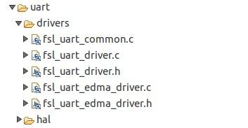

When I open the Project lib which is required to build my own project, I see the 'osa' and 'platform' folders. Within 'platform/uart/drivers' there are the uart specific files:
     -fsl_uart_common.c
     -fsl_uart_driver.c
     -fsl_uart_driver.h
     -fsl_uart_edma_driver.c
     -fsl_uart_edma_driver.h
and that's it. I guess irq should be here.
