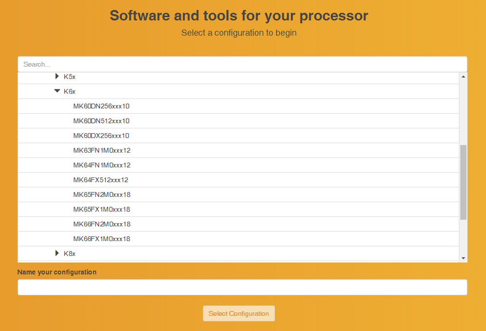

in a previous project I have already used the MK60FX512VLQ15 in CodeWarrior and MQX, Now I'll work on a new version of the project and I'd like to use KSDK for the first time. So I need to know wether this Microcontroller is supported by the KSDK or not.
If not, is there any other pin to pin compatible microcontroller supported by KSDK?
Thanks in advance
Tags (3)
265 Views
Hui_Ma
Unfortunately, the KSDK software doesn't support K60_120/150MHz products so far.
Please check below picture about KSDK software supported K6x products:
Wish it helps.
