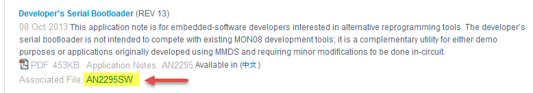

Hello Eunseok Jung:
For the MK10DX256VLH7 you may start with the AN2295, which is a serial bootloader. The others you mentioned are Ethernet and USB bootloaders, but K10 parts do not have those modules.
The link above is for the appnote document. To download the corresponding software (AN2295SW) please run a search in Freescale website for AN2295 and you will find the link to download:
Unzip the folder and you will find the projects available for IAR, CodeWarrior and Keil in "an2295sw\src\Kinetis".
There are different build configurations. The closest one to your K10 is the configuration for K20_72MHz. You just have to adapt a couple files to match your K10 MCU:
- bootloader_cfg.h
- AN2295_TWR_K20D72_cfg.h
- AN2295_LinkerFile
Then should be ready to go.
