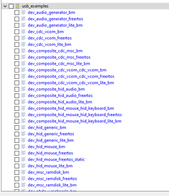

In order to understand your case, I have some questions, Are you want to use the MK22 as a Host or Device? in the case of a Device I have some suggestions. The Mk22 does not have support for USB C but I found the following information.
Source: PTN5150A-RM.pdf (nxp.com)
In the Reference manual of the PTN5150 chapter 5. Different Operation Modes I suggest you can use the Mk22 as [Device (UFP) Mode] through the PN5150. If this is right in the SDK of the Mk22 there are many examples for USB.
