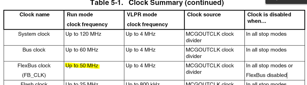

I also see this in the K64 Sub-Family Reference Manual:
If my assumptions are correct and we are setting the FlexBus clock to 60 Mhz, does it actually run at 60 Mhz or does the chip limit it to 50 Mhz internally?

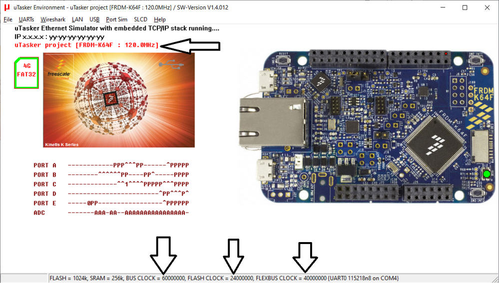

Hi Andrew
The bus speeds are set in the register SIM_CLKDIV1, which is usually performed before setting the PLL to its operating speed in order to ensure not overclocking any of the buses (for example, overclocking the flash bus will cause immediate failure).
It is the responsibility of the code to keep to limits - the chip won't limit and an incorrect clock may cause malfunction if actually used.
SIM_CLKDIV1 = 0x01240000; for example (with 120MHz PLL output) gives 120MHz core, 60MHz bus, 24MHz flash and 40MHz flex clocks, as show in the following simulation:
Mark

Hi Andrew,
In the Reference Manual, in the Clock Distribution Chapter, the internal clocking requirements says that the FlexBus clock frequency must be programmed to 50 Mhz or less and an integer divide of the core clock.

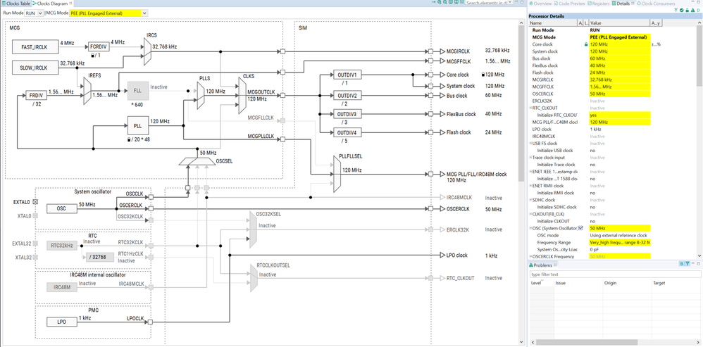

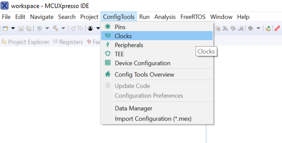

If you need to configurate your clocks, in the MCUXpresso, there is a way to do it in a friendly way, using the ConfigTools.
This tool gives you the clock diagram, where you can see the clocks frequency and configurate them.
You can download the ConfigTools User Guide to know more about this tool.
Ricardo
1,387 Views
adarrow
Thanks for the information RicardoZamora‌. I am using KSDK 1.3.0 but it looks like there a similar function called CLOCK_SYS_GetFreq. I was able to determine what our clocks were set to but I'll have to remember this function for future use. We use KDS in our day to day work but I did have a look at MCUXpresso and the Clocks Tool looks great, much easier to understand than the old PE method.

mjbcswitzerland
Specialist V
Hi Andrew
Mark
