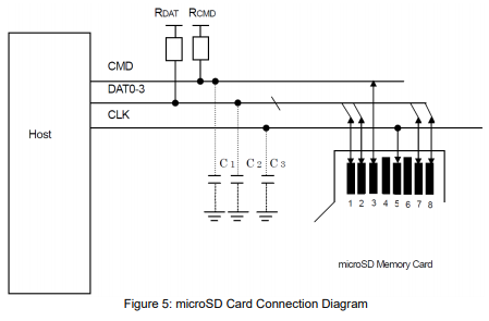

It looks like it may be a hardware design fault.  I immediately noticed that the circuit design in the document that you referenced is quite different.  It has PULL-DOWN resistors on DAT1 and DAT2 signals...
...while manufacturer's specify pull-ups, like this one from Kingston:
Mine has PULL-UP resistors on DAT1 and DAT2 only, and no pull-ups on any on the SPI signals at all, and so relies on the K8I's internal pad pull-ups instead.  I also notice from your reference document that the pull-ups/downs are quite strong – 10KΩ, while my pull-ups are much weaker –  100KΩ for the external pull-ups, and I think the K8x internal pull-ups are somewhere in-between – 47KΩ.
This is what happens electrically;
With and SD card inserted, if I apply the K8x pad pull-ups, with no VDD present, then the card keeps all SPI signals low.  When VDD is applied, the card releases CS, CK and  MISO, and they immediately go high, but MOSI appears to remain driven low by the SD card.
Denis

Looks like it was a hardware issue - the internal pull-ups may not be strong enough. I soldered some 10K pull-ups on:
  • CMD/DI - SPI_MOSI
  • DAT0/DO - SPI_MISO
  • DAT3/CS - SPI_CS.
  • DAT1 & DAT2
Now, all the pins, including MISO, are at the correct levels.

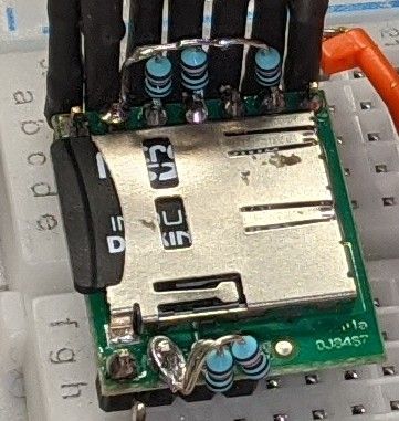

I don't have an evaluation board equipped with its own MicroSD socket.  But I do have a Freedom K82F board. I'll see if I can add a MicroSD socket, using a breadboard.
Best,
Denis
1,731 次查看
deniscollis
Contributor V
Okay, I have this (uses SPI2, like the custom board):
