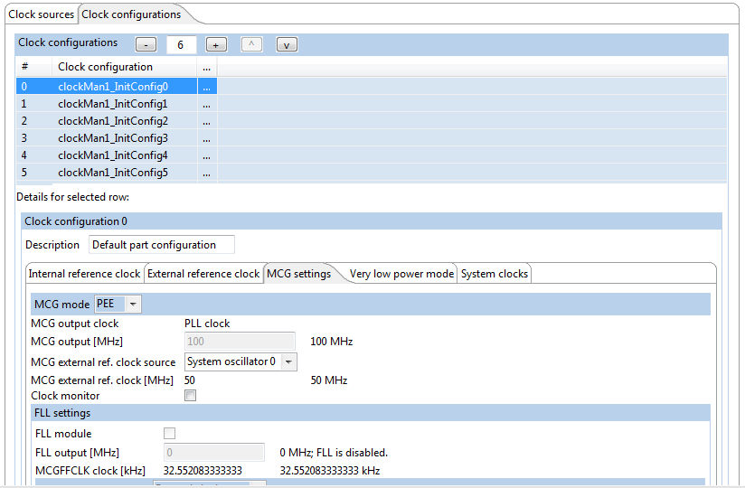

I use "fsl_clock_manager" to set the system clock to 100MHz.

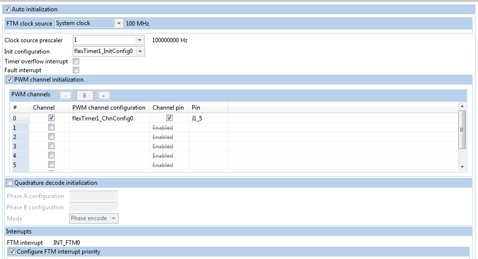

And then I set the 'fsl_ftm' component like this:
And then, I click "Generate Processor Expert Code" button and write the following code in main.c:
FTM_DRV_Init(FSL_FLEXTIMER1,&flexTimer1_InitConfig0);
FTM_DRV_SetClock(FSL_FLEXTIMER1, kClock_source_FTM_SystemClk,kFtmDividedBy1);
FTM_DRV_PwmStart(FSL_FLEXTIMER1,&flexTimer1_ChnConfig0,0U);
FTM_HAL_SetSoftwareTriggerCmd(FTM0_BASE, true);
Did I miss anything? Setting or code?

The FTM is fed by the bus clock which in this case is 50 MHz. If you view the reference manual, the PWM period is the counts to overflow the timer and the PWM pulse duration depends on the counts configured per channel. For example, if the timer needs 100 counts (FTMx_CNT) to overflow, and the channel value (FTMx_CnV) is 35, when the FTMx_CNT is less than 35 the output will be high and it will toggle when the counter and the channel value match. So, if you have a 50 MHz bus clock, the maximum PWM frequency will be 25 MHz and you will be able to have 0%, 50% or 100% of duty cycle.
