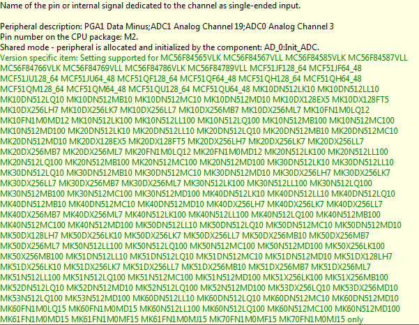

I addition to the above, it seems the that linker script had been overwritten at some point during the work, and the ".programbuf" section was no longer present. - When I reinstated this (and applied some workarounds based on the above replies) I've made more progress.
I have the project configured in Processor Expert for the MK60DN512VMD10 cpu, and am trying to setup the same project in the same way for the MK60DN512ZVMD10.
For the most part (so far!) this has largely amounted to changing pin names in the GPIO_LDD components (same pins, slightly different name in the cpu definition, quite annoying ), however I've reached a sticking point with Channel19 of ADC1 (component Init_ADC).
For the non-Z version of the CPU I have this:
However on the 'Z' version of the CPU I have the following error if I try to do the same:
The detailed tooltip popup for each is as follows:
MK60DN512:
MK60DN512 ADC1 Ch11MK60DN512 ADC1 Ch11
MK60DN512Z:
MK60DN512Z ADC1 Ch11MK60DN512Z ADC1 Ch11
I've search the above provided documents, but couldn't see anything that related to ADC (in a way that might affect this).
Is this an actual device difference, or an issue with the ProcessorExpert logic? - Either way is there any more information available and as to how I might be able to work around it?
Thanks again!

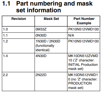

Both the MK60DN512 and the PK60DN512Z are part numbers for the same controller, however they represent different silicon revisions. With different silicon revisions, there are also many differences overall which means that the code used for one will most definitely not fit the other. This is all described in the following Application Note: https://www.nxp.com/docs/en/application-note/AN4445.pdf

1,371 Views
PhilV
Many thanks for this information, I shall take a look through the AN - I had to this point only had the errata sheets.
have reconfigured CodeWarrior Processor Expert to target the "MK60DN512ZVMD10" as there is no "PK..." part, but I think they should be identical for this purpose since they are both "Z" silicon?
The table at the start of the AN shows this:
My "4N30D" part is therefore obviously a "1.4", however can you tell me where the 5N22D fits in? Originally I thought perhaps a higher "number" was a newer version, but from the table above "2N22D" is newer than "4N30D", so that logic does not follow.
I also have a MK60DN512Z part that has silicon mask 8N30D ... are you able to advice which 'version' that would be as well please?
1,361 Views
EdwinHz
Of course!
You can find this information on Table 1 of the following document: https://www.nxp.com/docs/en/engineering-bulletin/EB782.pdf
