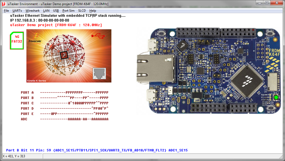

The new Freedom board was unveiled at FTF Americas today I believe.
A port of the uTasker project has been made to it including board simulation as show below below - anyone who would like to play with a virtual FRDM-K64F can do so with the executable at http://www.utasker.com/Demos/exes/Kinetis/FRDM-K64F.zip
Just unzip the file and execute "uTasker_FRDM-K64F.exe" - this needs no installatiom but does need Winpcap to be installed on the PC (if you have Wireshark installed it is already there). The simulated device can be contacted on the IP address 192.168.0.3 (web server, FTP, TELNET) and connects its UART0 to COM9 (using a virtual loop back to an emulator allows a command line menu to be played with - also the web server allows various things to be controlled). USB enumeration is simulated in the USB menu.
Hover your mouse over FRDM-K64F connectors to see the processor pins that they are connected to, their location on the processor, their present state and the peripheral functions that they support.
The 3 colour LED is also simulated - in the I/O command line menu (Telnet or UART) the ports can be controlled to turn on and off different colours to test the colour mixing.
Hope you have fun with it!!

Whilst making some first attempts with the new KDS [see First experence with KDS (Beta) with FRDM-K64F] I used the opportunity to work with the FRDM-K64F and configured a boot loader containing the following features (as well as an application exercising various board capabilities):
- UART interface allowing checking for and deleting application code (I removed the SREC loading because the OpenSDA virtual COM doesn't support XON/OFF which is needed to use 115kBaud)
- USB HID compatible with the Freescale HID loader program (HIDBootloader.exe from application note package AN4764)
- SD card
- Ethernet Web server
Attached is a SW pack for anyone interesting in using it. It contains:
- uTaskerSerialBoot.bin  This can be loaded with the MBED loader on the FRDM-K64F and is a single software (a little smaller that 32k in size) that contains all loaders mentioned above
- uTaskerV1.4_BM.bin is an application for the board (see below what it can do) that can be uploaded to the board from a web browser (board's IP address is 192.168.0.125.
- uTaskerV1.4_BM.srec is the same application that can be uploaded using the HID loader program via USB (use uTasker_Kinetis_1MKB_PFlash.imp, also included, as configuration file in HIDBootloader.exe)
- software.bin is the same application that can be loaded by copying it to a micro SD card and inserting into the board (then resetting)
To force the boot loader hold SW2 at reset. The boot loader always starts if an SD card is inserted and checks for new content before jumping to the application (keep SW2 held down for about 5s to remain in the boot loader in this case). The UART output is via the OpenSDA virtual COM at 115k Baud.
