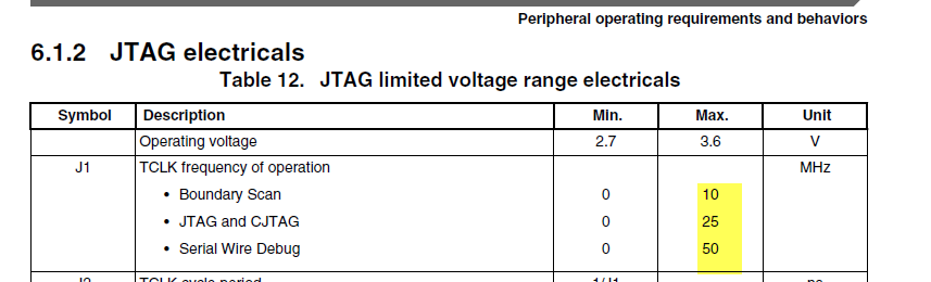

What is the maximum TCK frequency on MK10DX256VMC7 ?

Thank you very much, Kerry. For some reason, when I did a search in the datasheet earlier I could not find this info.   I downloaded the datasheet again. Sure enough, I can find that. Appreciate your help.

Hi Gurushankar Ramamurthy ,
   Please check the MK10DX256VMC7 datasheet:
Wish it helps you!
