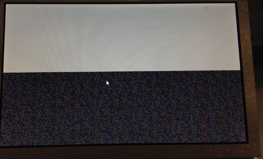

I am trying to get 800x480 display to run in 16bpp mode, and can also make it work. But It seems like the frame buffer has to be interleaved after each Hsync. Meaning that I have to make my frame buffer twice the size.
Can that be the case our is the DMA settings not correct?

If I do not add twice as many bytes in the frame buffer (see line 06 and 25 above) I only get half the display see picture(halfScreen.jpg) and if I make the buffer double size (fullScreen.jpg) :
Hope for some help.

The solution was to set the virtual page correct up. My new best friend Martin has spotted that the virtual page is in 32 bit words:
Meaning that the virtual page should only be half the size.

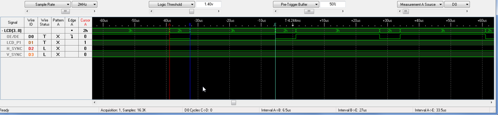

Thanks for the information!! Actually I just found the following note from the panel DS:
Note (1) Since this assembly is operated in DE only mode, Hsync and Vsync input signals should be set to
low logic level. Otherwise, this assembly would operate abnormally.
While from your diagram of device connection, HSYNC and VSYNC of K70 are connected with LVDS controller, and there would be high state on these two pins during transaction, so I am wondering if you have modified "void lcdc_init_pins()" accordingly. You may find the original code set PTF2 and PTF3 as HSYNC and VSYNC.
  PORTF_PCR2=ALT7;  // Graphic LCD HSYNC, Schematic PTF2
  PORTF_PCR3=ALT7;  // Graphic LCD VSYNC, Schematic PTF3
If you still use the original lcdc_init_pins(), please set PTF2 and PTF3 to GPIO function and output low to check if there is any difference after that.
Hope that helps,
Kan

Hi Kan,
I have tried to changed them to GPIO no luck:-(
I will try to measure the timing of OE.
Br. Peter

I have tried to measure the timing of OE or DE as the Panel data sheet call it:
From data sheet:
Blanking:     (1/30e6)*192          =     6.4us
Measured                                 =     6.5 us
Active:     (1/30e6)*800               =      26.67us
Measured                                  =      27us
The vertical timing is all so okay see picture:
From data sheet:
Typical timing:      (1/30e6) *20*992      =      661.33us
Max:                    (1/30e6) *20*1090   =       726.67us
Measured:                                         =       700 us
So in my view the timing is okay.

In order to prof that in 16 bpp mode there is some thing wrong with the DMA burst I have make an example where the frame buffer look like this:
0x08400000 : ff ff ff ff ff ff ff ff ff ff ff ff ff ff ff ff                                        //white
0x08400630 :ff ff ff ff ff ff ff ff ff ff ff ff ff ff ff ff
0x08400640 : 00 00 00 00 00 00 00 00 00 00 00 00 00 00 00 00      //Black
0x08400C70 : 00 00 00 00 00 00 00 00 00 00 00 00 00 00 00 00
0x08400C80 :ff ff ff ff ff ff ff ff ff ff ff ff ff ff ff ff
0x084BB7F0 : 00 00 00 00 00 00 00 00 00 00 00 00 00 00 00 00     //end of frame buffer 768000 bytes (800*480*2)
0x084BB800:60 81 50 5c 40 18 08 cc 26 08 22 e1 55 04 08 80     //Out of frame buffer random data
So I would expect a display showing first a white horizontal line and then a black etc...
But I get: 240 white lines and then 240 random lines see image:
So then is the question if the black lines are outside of the panel. Meaning that they are clocked out after a white line but no horizontal sync? In order to show that this is not the case I monitor LCD_P1 pin (Blue 0). If the black pixels are clocked out one should expect that LCD_P1 should go low after one Hsync (our in my cace one OE/DE cycle). This is not he case see image:
So is there some where I can set the increment of each line burst (DMA burst to LCDC)?
I my view it seems like it increments 32bit*800 and not 16bit*800 for each line in 16bpp mode.
Br. Peter Ilsoe
4,483 次查看
peterilsoeniels
