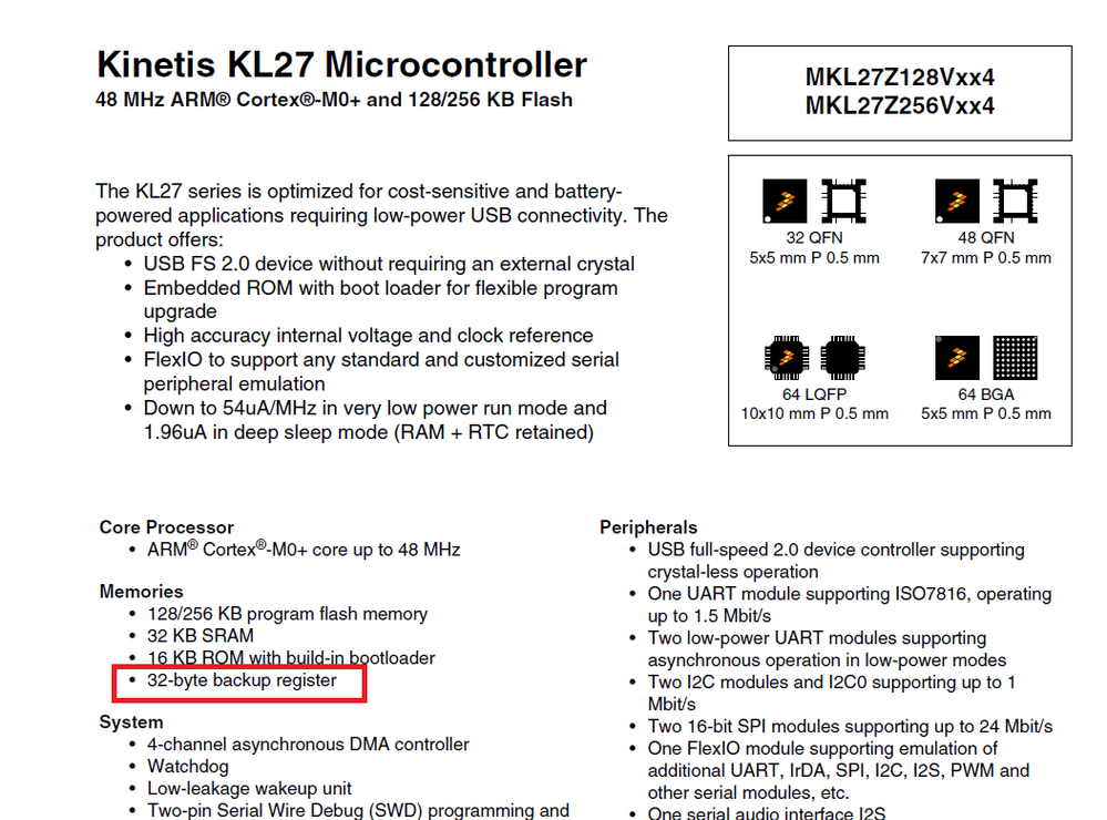

Now i am using KL27Z ( FRDM-KL43 EVM )
I have some question as below :
1. We survey USB / DFU Function now , have any AN can teach us how to use this ? Whether i have to download a USB FW then i can use DFU Function ? it's ROM Bootloader device , i don't think i need to download the USB Code first , so we need your help ~ thanks a lot !!
2. We prefer to copy code into RAM , Have any AN show this ? i need full function or Example to use this ~ thanks !!
3. I see the 32 byte Backup register in DS as below , but i haven't see it in RM . And what is this use for ? Have some introduce ? thanks a lot !!

Answer to your questions:
1. Please make reference from below post which is a summary on the Kinetis Bootloader:( See AN4370 )
Kinetis Bootloader 总结
2. As for the copy code into RAM, I am not sure what IDE are you using?
3. The 32-byte backup register file is for customer critical data that is is powered in all power modes. Also it retains contents during low-voltage detect (LVD) events and is only reset during a power-on reset.

   1. I has already download the code by DFU and make a sequence file as attachment 1. , but , how to modify " 5 sec " in ROM , if no USB / UART / I2C / SPI Detect , go to main API Code , How to modify " 5 sec "  ?
   2. I follow the attachment 2 to Relocate code into ram , it's ok ? it will make code more quickly ? or any other effect ? thanks
   3.  where can i find it shows in Reference Manual  , its function the same as define a parameter , what is difference between Backup register & unsigned char parameter ? power mode ? or others ? thanks a lot !!

Dear Fang Li ,
   1. I 'll do this first , any question i will update to you , thanks a lot !!
   2. IDE is MCUXpresso ,Need your help to check this ,  Thanks !!
   3. ok !! thanks !!
       And where can i find it shows in Reference Manual ? Thanks a lot !!
