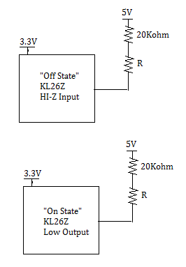

I want to configure a GPIO on the KL26Z we are using as a Hi-Z input (no internal pull up or down) that is externally pulled up to 5V through >20Kohm resistors and then to simulate button presses by turning that GPIO to a low output then back to a Hi-Z input. From the previous comment it seems that this is reasonable if the pins are 5V tolerant as inputs. I wanted to confirm this, or find where I am mistaken.

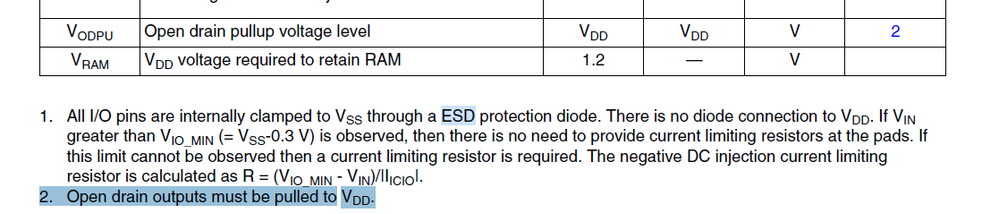

jingpan
No, not all kinetis have 5v tolerant pin.
This is table 5 in KL26 datasheet.
Yes, I agree pullup through a 20k resistor to 5V can protect the pin. The current is very small. Since there isn't ESD to VDD, there isn't current to VDD also.

tarikaweimrin
I understand it is not recommended.  I just want to know if it will cause damage.  In the "Off State" as an input with the external resistor there should be little current to damage the chip.  In the "On State" the GPIO is configured as a low output.  I don't think either state would damage the chip.  I just want to see if I am overlooking something.
803 Views
jingpan
I think it's fine.
