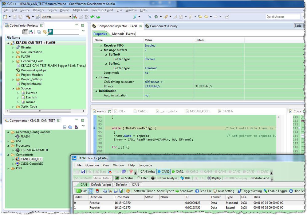

I am developing an application that requires a Single wire CAN application, I have my CAN analyzer connected to my single wire transceiver, I am trying to use the KEA128_CAN_TEST that I saw on other threads but it gets stuck in the While loop, I've seen that other developers have had the same issue that it does not hit the Interrupt, any suggestions on what I can do?

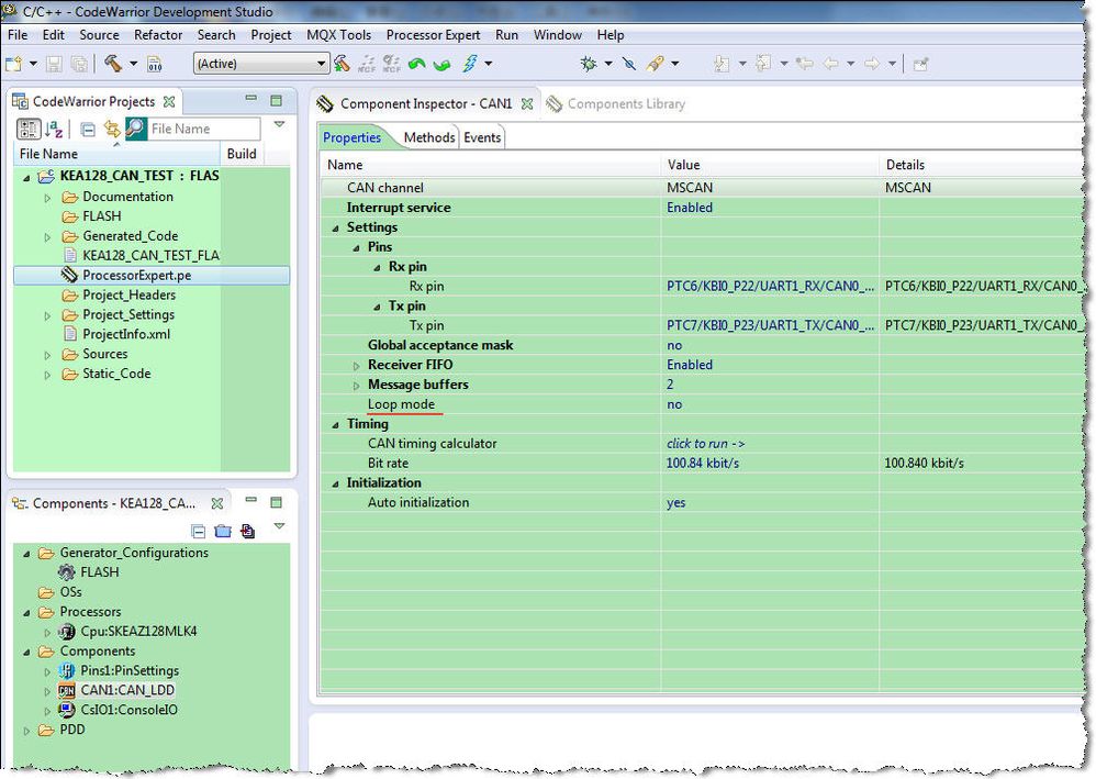

Have you modify the code of KEA128_CAN_TEST?
Please try to use the loop mode first.

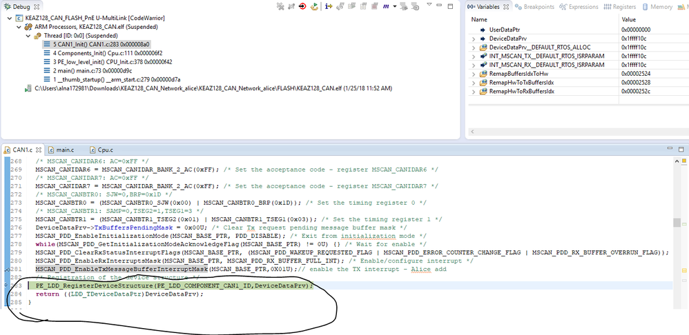

Yes, I already tried the loop mode and it works fine, I was reading that the PE is missing the TxMessageBufferInterrupt but I added that portion of the code and now it gets stuck at the next line.
I cannot do anything after I hit "PE_LDD_RegisterDeviceStructure(PE_LDD_COMPONENT_CAN1_ID, DeviceDataPrv);

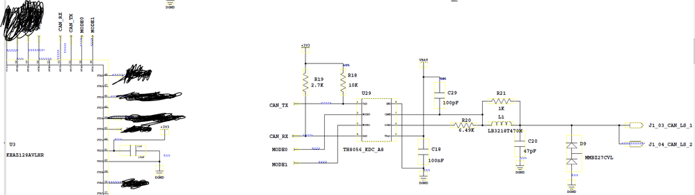

Here's the schematic of my single can Transceiver and the CAN lines of KEAZ

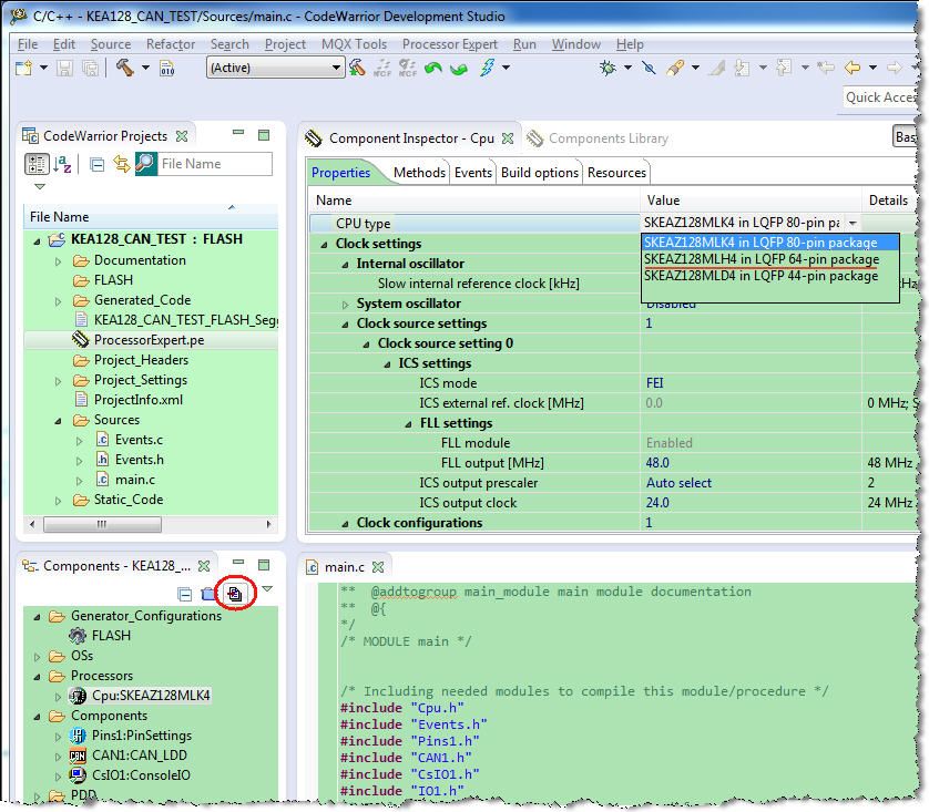

Please select CPU type to LQFP 64-pin and then Generate Processor Expter Code again.

The Bit rate of that example is 100.84kbit/s. So you may need to select High-Speed mode for TH8056: Mode 0 = 1, Mode 1 = 0

I had those changes in my project using the 64-pin package, and also I changed the Bit rate to 33.33kbit/s because that is the one I have to use for my application, so I am using Normal mode on the TH8056 that means Logic "1" on both pins.

Like I said before I still have the issue that it gets stuck in PE_LDD_RegisterDeviceStructure(PE_LDD_COMPONENT_CAN1_ID, DeviceDataPrv);"

Robin_Shen
I have modify the example in KEA128_CAN_TEST and attached here for you to refer.
I did not add MSCAN_PDD_EnableTxMessageBufferInterruptMask in CAN1_Init function.

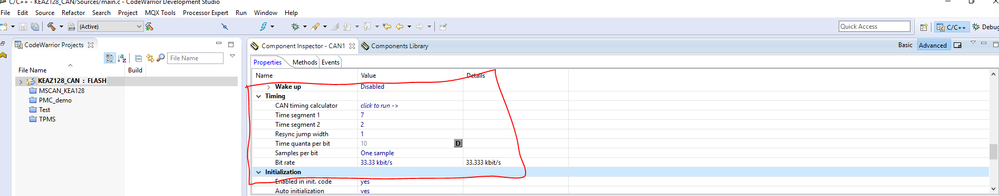

My TRK-KEA128 board can send data with 33.333 kbit/s Bit rate now.
