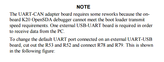

Our customer Delta would like to implement AN5219SW on their system but failed.
We support customer FRDM_KE06 2pcs but still not work.
Can you help? Thanks.

After working with Delta RD, the software package works on KEAZ128 EVB. Customer accept to use this auto grade EVB to run KE06 CAN bootloader.

Attached compiled binary(IAR).  I just use Jlink/IAR to download project, It’s OK to run. Download via CycMax and Jlink should have no difference.
Pay attention to this on AN5219:
  2. 2.       TerTerm baud rate setting must be 115200.
