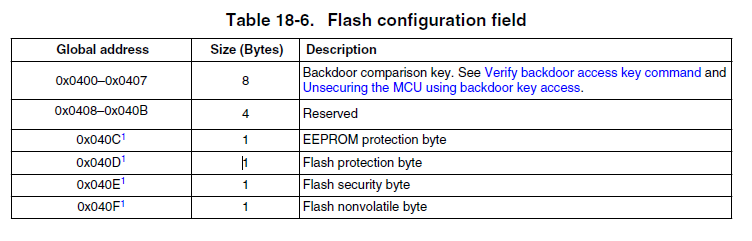

I'm trying to debug a custom board with a MKE02Z64VFM4 with the Kinetis Design Studio 2.0 and a CMSIS-DAP JTAG.
I'm facing an issue when downloading a simple application created with  KDS "Create new project" wizard. The result is that the MKE02 cannot be programmed because " Cannot access device, device is secured. Mass erasing a device will unsecure it until the next reset. To permanently unsecure, mass erase then flash a program containing an appropriate flash configuration field.". And then KDS ends the debug session.
Note that working with KEIL uVision, with the same JTAG and a GPIO demo from Freescale, the MKE02 works OK and can be reached by the JTAG an debugged with no problems. But for other reasons I cannot develop the final project using KEIL.
This is the complete output from KDS, executing OpenOCD with the "-f kinetis.cfg --debug 4" parameters (full debug output). The bold at the end was added by me.

Trying to understand more I've downloaded the KDS 2.0 source code (http://cache.freescale.com/lgfiles/KDS/KDS-v2.0.0-source-files.zip?fpsp=1&WT_TYPE=IDE%20-%20Debug,%2...) to see the modifications Freescale has made to OpenOCD to enable MKE devices support.
Looking at the patch file openocd-0b26376_kds-2.0.0.patch I've noticed that OpenOCD was modified to do the following:
retval = target_read_u8(target, FSEC, &fsec);
if (retval != ERROR_OK) {
    LOG_ERROR("Cannot read FSEC. Device may be secured");
    LOG_INFO("Mass erasing a device will unsecure it until the next reset. "
         "To permanently unsecure, mass erase then flash a "
         "program containing an appropriate flash configuration field.");
    exit(-1);
else if ((fsec & 0x3) != 0x2) {
    LOG_ERROR("Cannot access device, device is secured");
    exit(-1);
But FSEC, on the same patch, is defined as
#define FSEC 0x0000040C
I know other Kinetis devices have the Flash Security Byte located at 0x40C, but for the MKE02 it's different:
So the question is: Is KDS 2.0 enabled to debug MKE02 devices with OpenOCD with CMSIS-DAP?
Has anyone managed to work and debug with said configuration?
Thank you.

BlackNight
Hi Ivan,
OpenOCD in KDS v3.0.0 is the same as the OpenOCD in v2.0.0. OpenOCD does not support the KE02 device. See list of supported devices of OpenOCD in the release notes. You can use either P&E or Segger instead.
I hope this helps,
Erich
