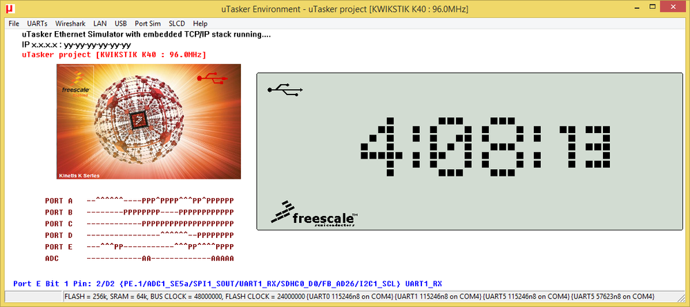

The Kwikstik (all versions - controlled by a define "KWIKSTIK_V3_V4" for backward compatibility to V5) is also fully supported in the uTasker project µTasker Kinetis support (as seen there, there is a list of about 10 tool chains that it can be used with without needing to worry about compatibility or porting efforts).
For accelerated developments it can also be built and simulated (for testing and debugging) using VisualStudio (Express edition is also free). Below is a screen shot showing how the Kwikstik looks when worked with.
