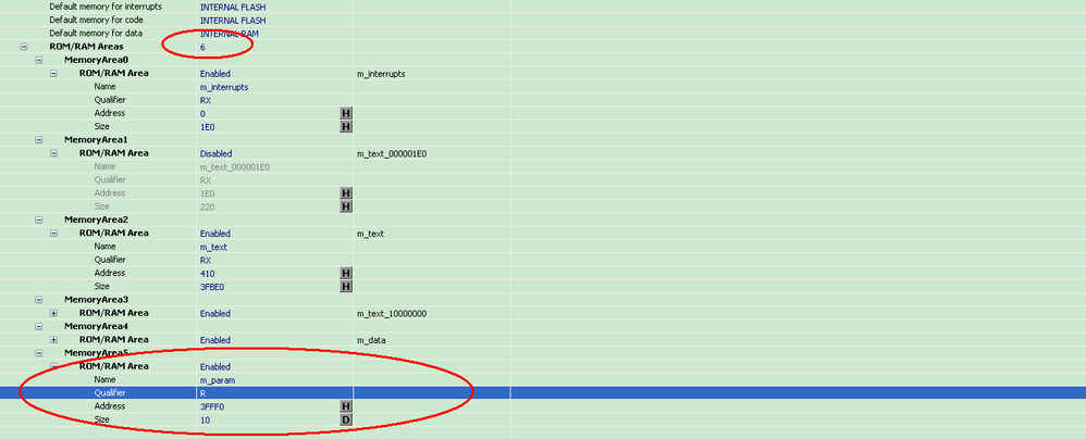

I want to store some default parameters in my Flash so that during boot-up time, my variables take those default values at start up.
How can I do this?
My controller is MK10DN512ZVLL10. And I am having a bare-metal project with the following build options:
Can you tell me what are these partitions like m_data and m_text for and how I can modify this, if I have to?
I want to specify a few parameters in Flash and let it stay forever. Then during start up, I would like to have a FLAG, if the flag is set, it means to take default parameters (will be our factory default parameters) for variables. If FLAG is clear it means start up the code normally.

To do that, you have to modify the build option to generate a new lcf file, for example, a new 16bytes long section "m_param" is defined as below:
and in your code, use the following to predefine the data stored into that section:
#pragma define_section m_param ".m_param" abs32 RX
static __declspec(m_param) uint8_t m_param[0x10] = {
0x04U, 0x03U, 0x02U, 0x01U, 0x08U, 0x07U, 0x06U, 0x05U,
0x09U, 0x0AU, 0x0BU, 0x0CU, 0x0DU, 0x0FU, 0x10U, 0x00U
Please kindly refer to attachment for more details. !

mehdikarimibiuk
Contributor V
PE has a flash API called FLASH_LDD.
However, I need to set aside a read only segment of my FLASH to store my factory default values (1KB is enough). It should be read-only so no-one must be able to write to it, intentionally or unintentionally. I think using Build options in PE CPU is a way to go, but I have had some problems so far in configuring it.
