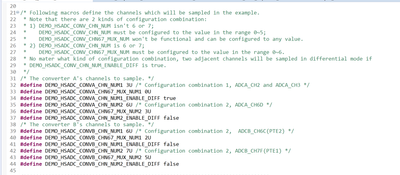

I am a little confused by the KV58 dual parallel conversion example. I see in the example they are using PTE1 and PTE2 which is HSADC0B_CH17 and HSADC0B_CH10.
Then they go to assign these channel numbers
How is ADCB_CH7, ADCB_CH6, ADCA_CH2, ADCA_CH6 linked to HSADC0B_CH17 and HSADC0B_CH10?
I am wanting to use both HSADC0 and HSADC1 to do 2 parallel conversions of the below pins on the KV56. I'm also wanting to use PDB to trigger the conversion which I don't see an example for.
AHSADC1A_CH2
BHSADC1B _CH2
CHSADC0B _CH2
DCHSADC0A _CH14
However, I don't quite understand the ADCA and ADCB channel assignments. I assume I don't just pick a channel 0-6 on ADCA and then 7-15 for ADCB or do I? I would think somehow the channels are linked to HSADC0A _CH14 for instance.

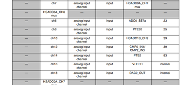

One question I do have - for the below to use CH 14 (pin 83) would this be mux number 4?
