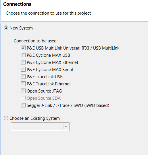

What's a good choice for a low-cost ($100 to $300) debugger for the Kinetis K series, that should also support the L series?
Needs to work with CodeWarrior 10.2 / 10.3
I suspect OSBDM from EBay is an option, but perhaps slow, as it is used on the tower boards (?), or CYCLONEMAX_PE, but it is $900, or perhaps PnE U-Multilink, but it has caveats as to which versions of CodeWarrior support it?
What do most of you professional devs use for debugging K series micros?

This is the CW10.3 supported tools:
J-Link and USB Multilink I think are the cheaper tools.
Luis
