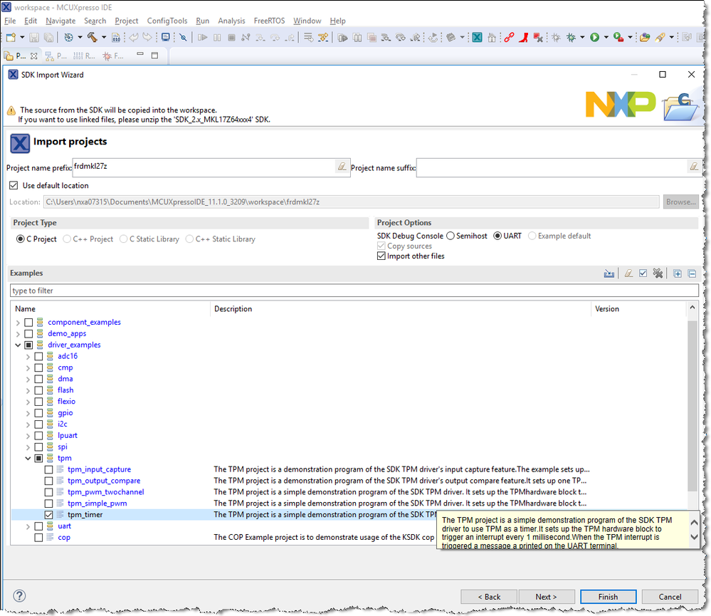

Robin_Shen
Hi gaston,

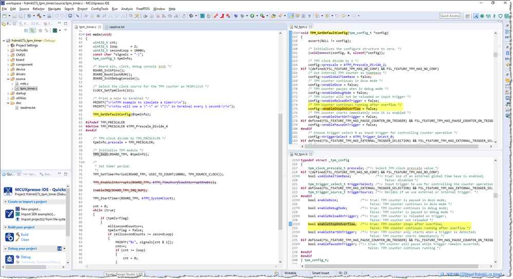

Have you try to refer the tpm_timer example in SDK_2.7.0_MKL17Z64xxx4?
enableStopOnOverflow = false; means TPM counter continues running after overflow.
You can disable below IRQ related codes.

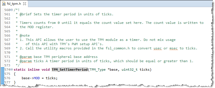

Seems that you don't need to interrupt 1ms anymore, so configure MOD=0xffff by using TPM_SetTimerPeriod function.
